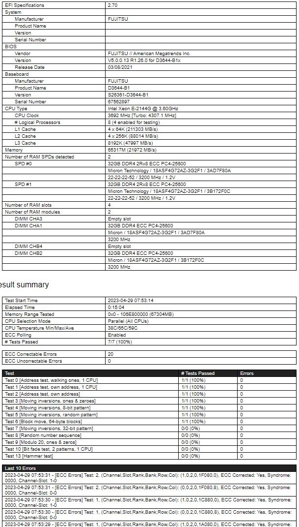

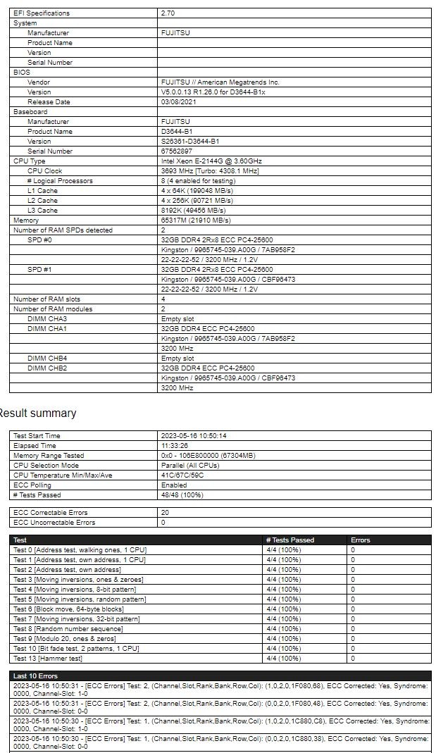

    Hello Everyone,
    I have a question regarding my new server build at home:
    When I did my burn-in-testing with Memtest86 it found correctable ECC errors.
    After those were pretty much always repoducelable I returned the modules and bought new ones.
    So with the new modules I get "Correctable Errors" again.
    You could think that's just bad luck, but it's exactly 20 correctable errors every run.
    Can that really be a coincidence?
    Attached screenshots from the summary, I could upload detailed logs if needed.
    Thanks and Regards
    Chris
    Yes, strange to get the same number of errors from two different sets of RAM.
    In both cases the errors appeared very early in the test run as well.
    Was almost like the memory controller had a bunch of queued up ECC errors to report before MemTest86 had even started the tests.
    On the other hand the channel / slot details in the ECC error report seem kind of believable.
    Wonder if it might be some type of BIOS bug where the ECC stuff isn't being initialised correctly via BIOS. So machine starts up with a bunch of fake ECC reports, but only once per cold boot.

                Thanks for the logs.
                The ECC errors look like legitimate errors reported by the chipset, though it appears to be triggered not by faulty RAM but on the memory controller side.
                This is indicated by the ECC status registers indicating no errors before the start of the test, but error bits are set once the test starts.
                Also, it appears that not all test runs result in ECC errors at the start of the test. The common occurrence for test runs resulting in ECC errors is that the CPU temperatures are relatively low (~40C). Even after clearing the status registers, the same ECC errors are detected until they disappear after a certain amount of time (around test 2).
