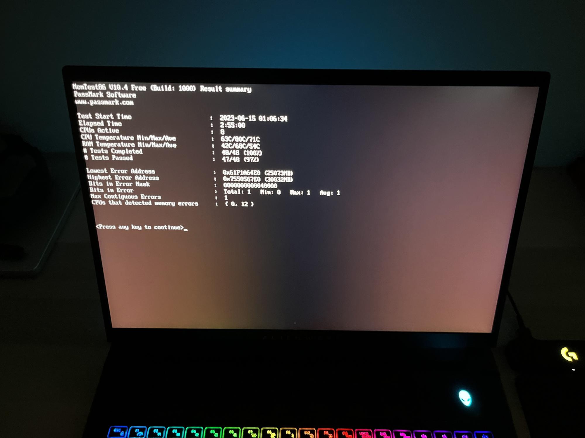

    Hello guys, I have recently installed some new kits for my laptop. I ran memtest86 just in case there are any issues with me running these relatively new and fast xmp kits on a laptop. I ran the test twice, In the first run I had two errors at test 7 during pass 2, and in the second run, I had one error at test 7 during pass 2 again.
    How concerned should I be, from my understanding these single-bit flip errors can mostly rule out other non-ram related possibilities, however, these kits only became supported on the latest revision of the bios literally released three days ago, so maybe I am running on the fringes in terms of compatibility?
    Just in case I would have to live with these errors, if they go uncorrected, how badly would they affect me in a broad sense, if I used the computer for a few weeks after noticing these errors in memtest, would I be planting a bomb for myself in terms of corrupting my os.
    Lastly, one more oddity I noticed is after I finish the first run and booted back into Windows, my memory integrity was turned off, this did not reoccur after my second run. Is this a known bug?
    Thanks, guys!

    These are the results of my first run:
    Yes.
    Might get really lucky and go for years without this provoking a problem.
    But might be unlucky and have it crash the machine frequently at random. Or anything in between.
    MemTest86 doesn't touch any settings in Windows, nor files on the boot drive, nor BIOS settings.
