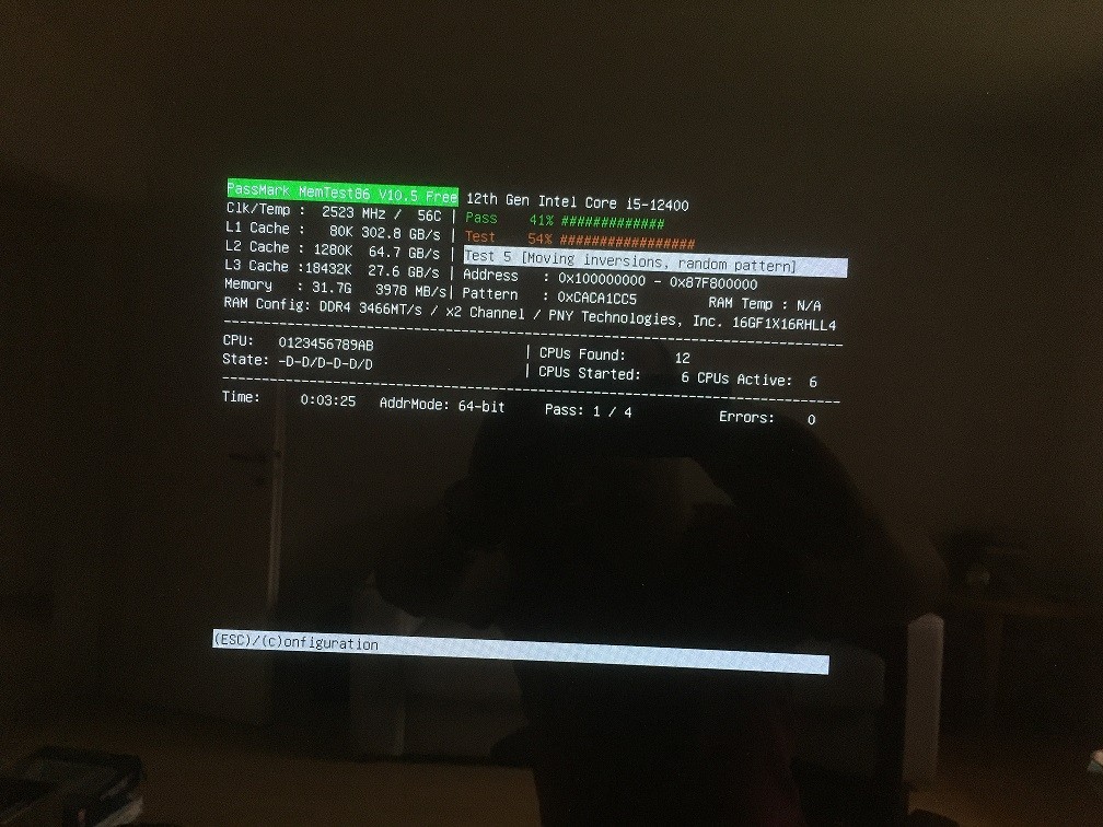

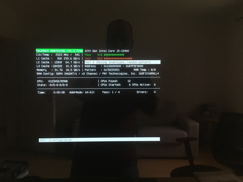

    So I've been running MemTest86 a lot lately and I noticed inconsistencies,
    The first ones I noticed were those L3 Cache and Memory speed reports.
    Then I noticed a full successfull Memtest lasted sometimes less than 4h and sometimes more than 5h.
    You can see here for example, one time 54% of test 5 in 3mn25s, the next time 56% of test 5 in 5mn8s
    I'm pretty sure those 2 tests were done using the same settings (which seem stable so far)
    Any ideas ?

    Yes, this is a bit strange. I also note that the benchmark GB/sec numbers for the RAM speed were pretty different.
    (but the clock speed of 3466MT/Sec was the same).

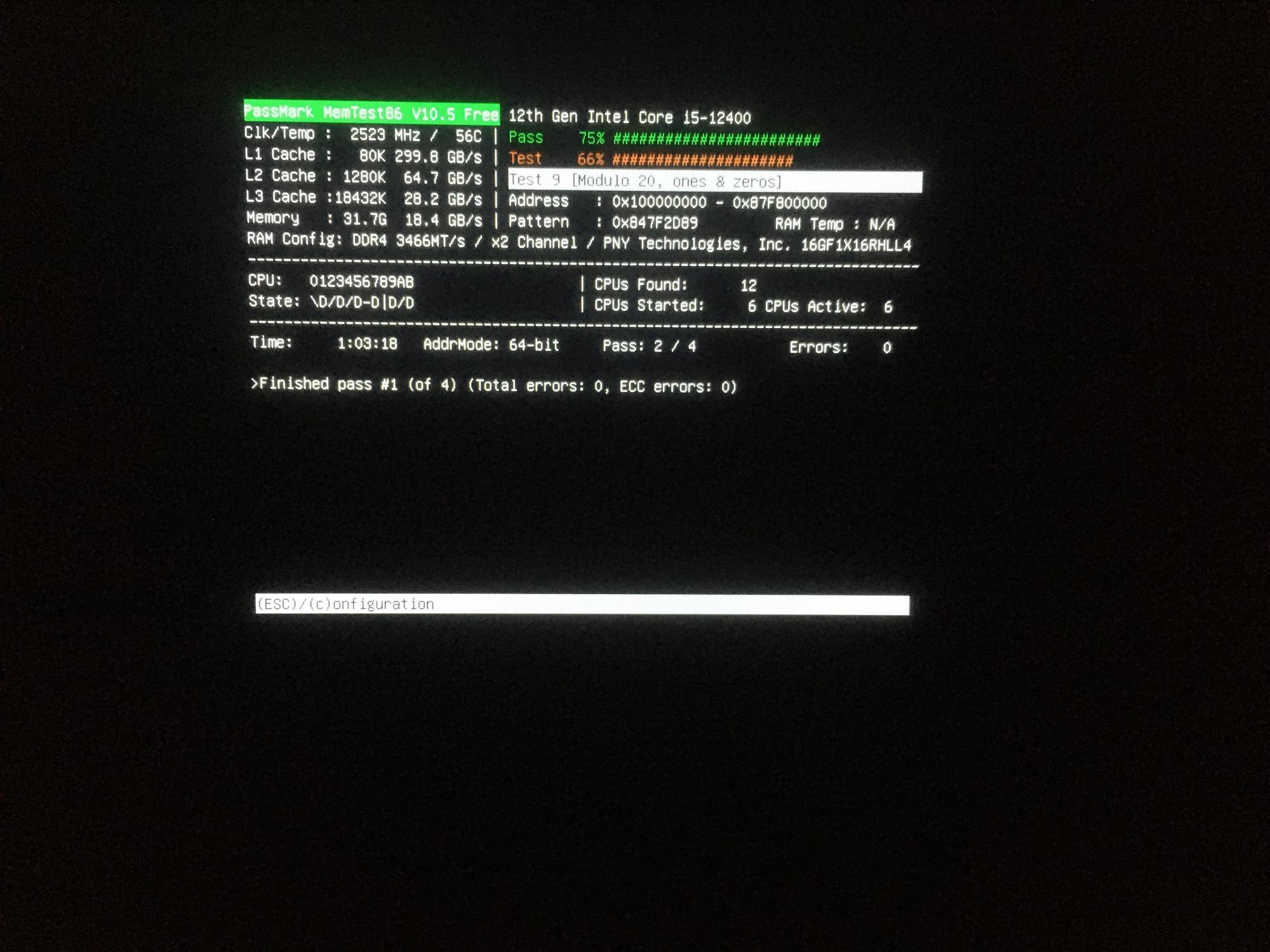

            Can you tell me which are the right speeds, is it L3 Cache 27.6GB/s and Memory 3978MB/s or is it L3 Cache 10.3GB/s and Memory 18.5GB/s ?
            So I know where I'm at when I test... (the first set makes more sense to me, cache should be faster than Ram)
                The 2nd faster set of numbers is more typical, but still low.
                Cache speeds of around 50GB/s are possible. And L3 cache should be faster than main RAM.
                (3978MB/s is actually slower than some current hard drives)
                So neither set of numbers is OK in the end.
