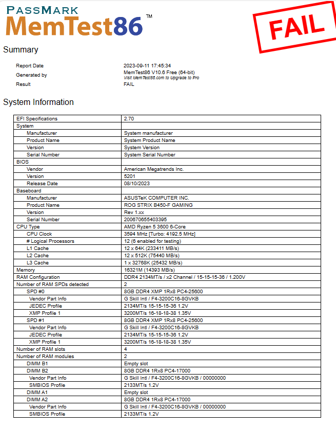

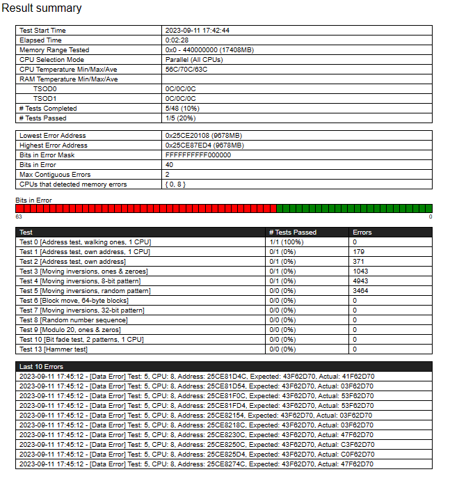

                Wow, so I had deleted that extra drive on the USB, so I had to create a new boot disk and run the test again and again when I tried to boot to the USB it just hung on a black screen. I tried several BIOS settings and boot options and finally logged back into this forum to post, and I saw the question a few posts below mine that said it was hanging on a black screen and wouldn't boot. I saw that you said it was showing something with the CDROM drive. Someone had posted that they just took the CD out per your suggestion, and it worked...I took "The Black Stallion" out of my CDROM drive and rebooted and selected the first partition and BAM...it worked. Once again it hit 10,000 errors and said failed. Attached are the log files.... now what do they mean?!!

                      Here is the HTML Report...
                        Yes, that is a lot of errors.
                        Something is definitely wrong. Likely bad hardware or hardware configuration (e.g. voltages and timings)
                        See this page to start with.
