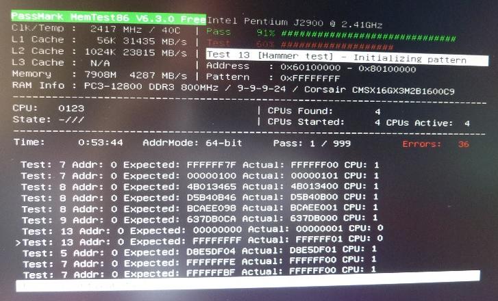

              CPU parallel test mode and address 0 errors: Check your CSM setting in UEFI BIOS!
              Hi Guys
              regarding CPU test mode "parallel" and strange "addr. 0" errors:
              I own two ASRock Boards (Q1900B-ITX and Q2900-ITX, Quadcore Celeron/Pentium, latest BIOS installed), each fitted with 2 pairs of Corsair Vengeance 8GB DDR3L CMSX16GX3M2B1600C9 (so 16 GB in sum per Board).
              In concern about very rare / sporatic occurring Win10 freezes (most times when using Firefox x64) I was going to check the RAM using MemTest86 6.3.0 (USB).
              Result: Most times the test # 3, 4, 5, 7, 8, 9 and 13 has reported addr. 0 errors when using parallel CPU mode (never in single mode), and for 90% triggered by CPU 1. Curious: Just the LSB of the DWORD did differ between "expected" and "actual".
              Example:
              I couldn't beleave, that this was caused by the RAMs.
              Then I could figure out by chance:
              If "CSM" (Compatibility Support Module in UEFI BIOS) is set at "OFF", I get the errors.
              If "ON", then there is absolutely no error coming up!
                #37
                Thanks for letting us know.
                Yes, it seemed unlikely that the errors were caused by a RAM fault which consistently appeared in the LSB of address 0. It is more likely that the UEFI BIOS was erroneously using memory that it has marked "free" for use. I'm not sure what enabling "CSM" does internally in the BIOS code but it seems to be a functional workaround for the MemTest86 errors, as you demonstrated.
                • Harry
                  • May 2016
                  #38
                  Yes, I think so too.
                  Today I've reported that problem to ASRock support because I'm very sure, that it's caused by UEFI and alike it happens on each of my 2 ASRock miniITX boards (they have slightly differend CPUs).
