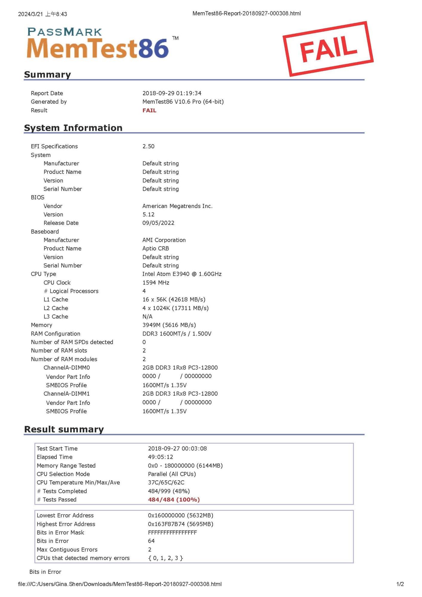

    MEM TEST V10.6 run 49 hours error (Errors:10000)
    "It appears that I'm encountering failures during the MEM TEST V10.6, with errors consistently occurring after 49 hours. This issue has occurred across three instances, all displaying the same problem (as shown in the image). Could I kindly ask for assistance from experts to diagnose the underlying cause of this issue?"

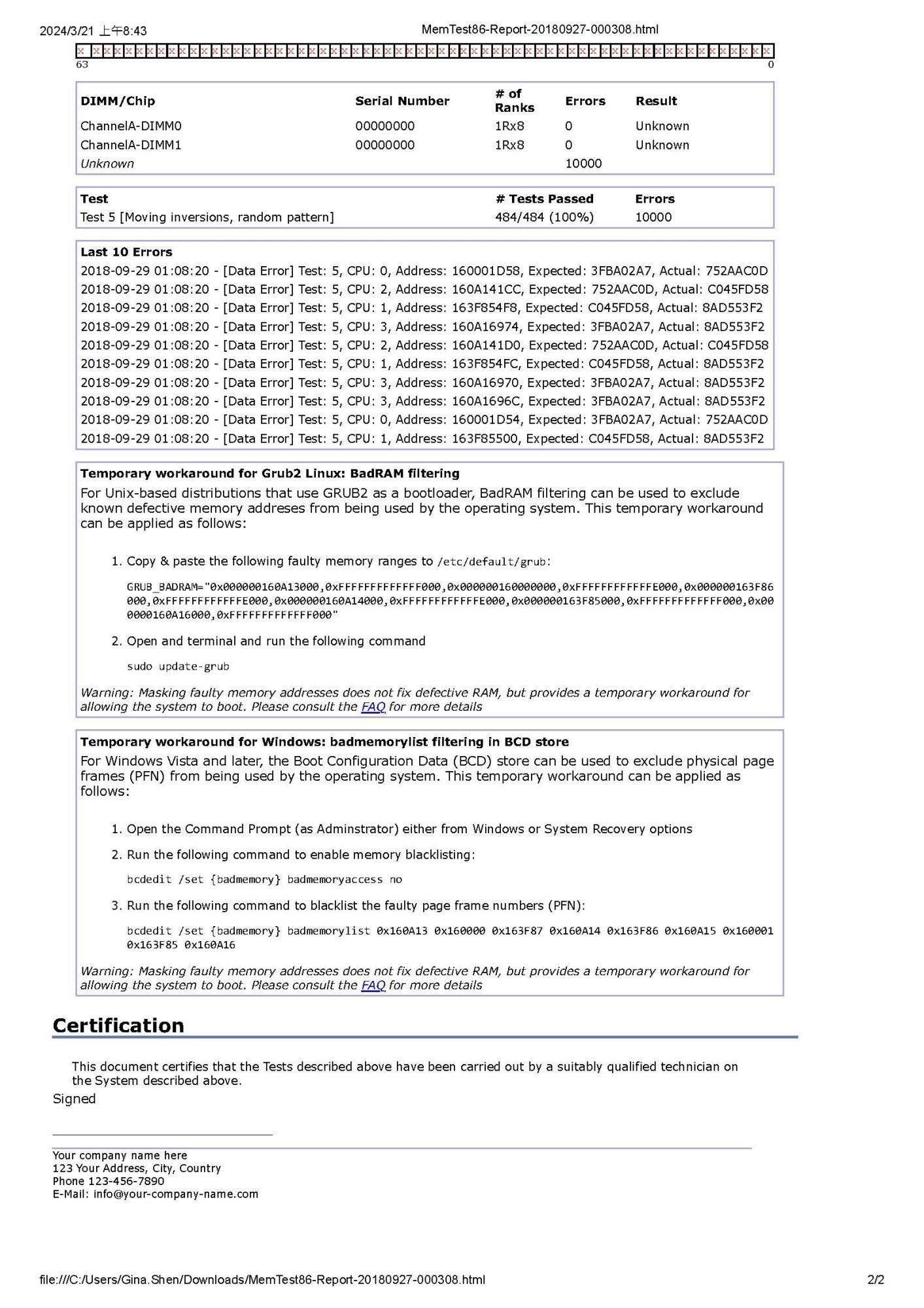

      ​Hello, these errors seem to occur within a minute just after 49 hours have elapsed, as if there's some sort of pattern to it. I've uploaded the test report for your review. Thank you.

                      We got log files via Email.
                      The logs were from the old V7 release of the software, which we no longer support. V10.7 is the current release. See
                      https://www.memtest86.com/whats-new.html
                      But none the less, these lines were found in the log file.
                      MPSupportTestMPServices - AP dispatch test
                      MPSupportTestMPServices - Starting AP#1
                      MPSupportTestMPServices - Starting AP#2
                      MPSupportTestMPServices - Starting AP#3
                      MPSupportTestMPServices - Waiting for AP's to complete execution
                      MPSupportTestMPServices - CPU #3 completed but did not signal (event wait time = 1001ms)
                      MPSupportTestMPServices - CPU #1 completed but did not signal (event wait time = 1018ms)
                      MPSupportTestMPServices - CPU #2 completed but did not signal (event wait time = 1033ms)
                      MPSupportTestMPServices - AP dispatch test complete
                      MP test failed. Setting default CPU mode to SINGLE
                      MP = Multiprocessor
                      BSP = Bootstrap CPU (the main CPU core, which is started first)
                      AP = Application CPU (this is a CPU core)​
                      So this system failed the Multi-process test. The software forced the CPU test mode to Single thread as a result. But the user overrode that setting and selected Multi-process testing anyway. Which unsurprisingly failed.
                      So this is a UEFI bug. You can also find some details of the issue here
                      https://forums.passmark.com/memtest8...election-modes
                      We have seen this before on older systems.
