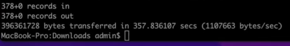

    It shouldn't take an hour, unless your USB drive was insanely slow or had errors.
    At the end of the process it should show a report like this,
    Can you try with another USB drive.
