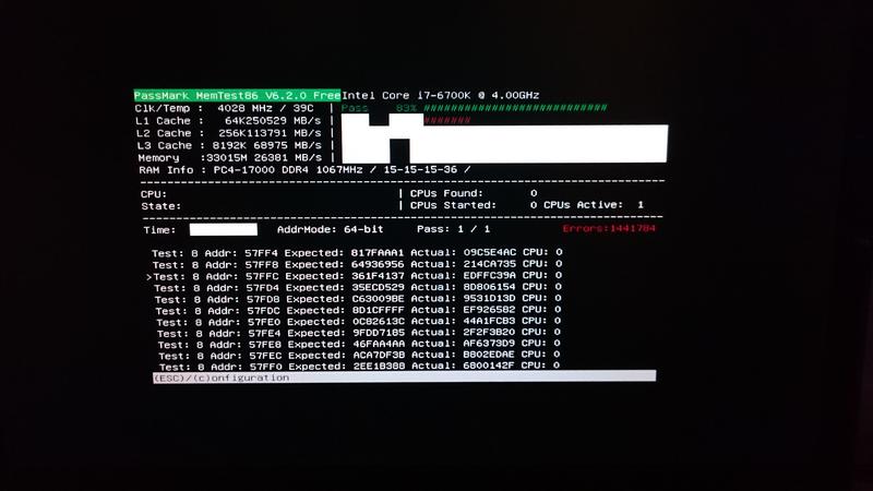

      Update: Uhm, it might be hard to post a log, since every single write/read op is failing after a certain point. 300 000 errors after just a minute or so, and the test timer hasn't moved a second while continuing the error count. The log should be gigantic if nothing else... I'll leave the test on and see how it goes though. I have contacted Gigabyte as well (the RAM sticks are in the motherboard QVL, I had hoped they'd be compatible), no answer yet though.
        So now I got this too... known bug or some other issue? (It doesn't seem to have crashed though, funnily enough. Test is still progressing.)

              Thanks for the logs. It looks like there was a problem with retrieving the multiprocessor details from the UEFI firmware. This may or may not be related to the errors you are seeing but it is an indicator of incomplete/buggy firmware:
              2015-10-28 07:33:37 - Successfully located the PI MpService protocol.
              2015-10-28 07:33:37 - WhoAmI failed: Not Found
              Nevertheless, we compiled a debug build that will output the exact pattern that is written to memory (for the first 256 bytes), so we can verify if the errors are indeed real. Can you give the following build a try:
              http://www.passmark.com/ftp/memtest8...6.2.0.1005.zip
              Please select only Test 8 and run the test for at least 5 minutes. It will run quite a bit slower as it will be writing a log of debug output to the log file.

                  Working like a charm now - CPU and RAM SPD detection is working as it should (detecting CPU cores and threads correctly, and frequency of the RAM depending on JEDEC or XMP setting), and the test is showing no errors at all, with all 4 sticks running in XMP mode.
                  Thanks a lot, one burden off my mind! Do you need the logs this time around? (500kb for 10min, slightly less truncated than the regular log. )

                        Thanks for that. Here's a new build with the debug output removed:
                        http://www.passmark.com/ftp/memtest8...6.2.0.1006.zip
                        The problem was indeed related to the bug in the UEFI firmware's multiprocessor services, which indirectly caused problems with our random number generation functions. This affected all tests that use these functions including Test 8. We were able to add a workaround for the bug and it appears to have worked. However, it is possible that the firmware bug may affect other functionality that use the multiprocessor services such as running MemTest86 in the various CPU selection modes (parallel, round robin, etc.)
