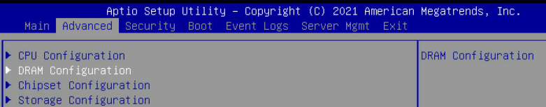

        Also very interesting...this might be a cause. This looks like what you mean by "Quick Boot":
        DRAM Confguration settings:

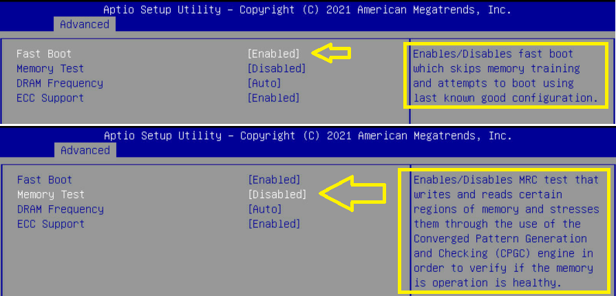

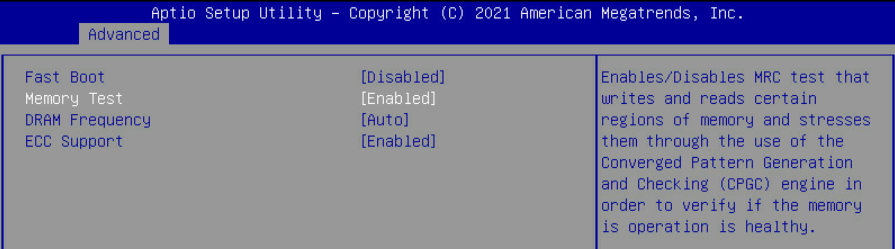

        I will reverse these and see if I still get ECC errors:​

          Dang...doesn't seem to have made a blind bit of difference:

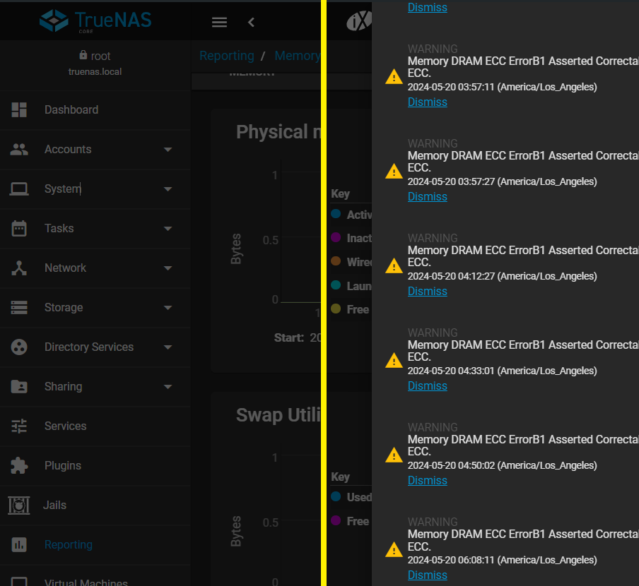

                ECC errors might be real however. Would be interesting to see if they also get recorded in Linux or Windows event log as errors (you would need to place the machine under memory load in the O/S to see this).
                  You mean like this?
