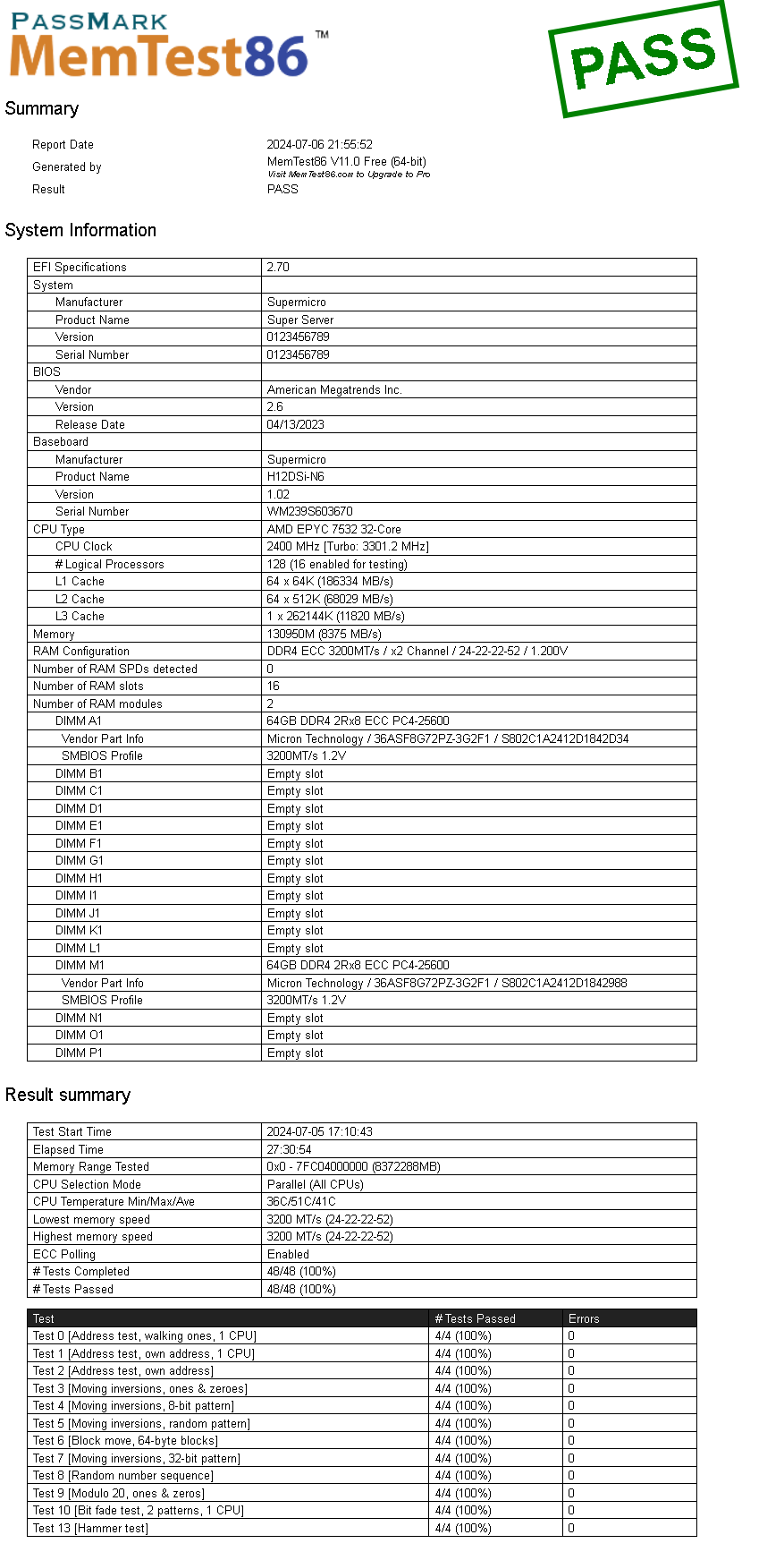

              Hi David,
              Thank you again for the replies above. I returned the two ram sticks from eBay, and went for "proper" RAM sticks directly from Crucial/Micron: https://www.crucial.com/memory/serve...MjEzMDIzNTY0OA..
              It seems that was indeed the issue, as Memtest86 passed all 4/4 passes when placing these sticks in the same mobo slots, same settings, etc.
              The only thing that showed up this time was "[UEFI Firmware Error] Could not start CPU 8" (it's possible this showed up before as well and I didn't catch it in time before all the ECC error messages), but that did not keep memtest86 from finishing and passing all 4 passes. From reading other posts, it seems that there is a good chance this is some kind of UEFI bug, and not something actually wrong with my CPU -- but I couldn't find a way of how to get a definitive answer or not. Do you know how I could confirm or deny this?
Name:	UEFI firmware error screenshot.png
              Attaching the new log (compressed as 2.3mb exceed the upload limit) as well as screenshot of the finished HTML report that was able to output this time.
              It did take a very long ~27 hours for 128gb of RAM to finish 4 passes. I'm scared to attempt the full 1TB that I'll install in the machine -- I presume the time to finish will scale linearly? If so, that's a whopping 9-10 days so maybe I'll just do 1-2 passes only?
              And again, thank you for the help on this!
