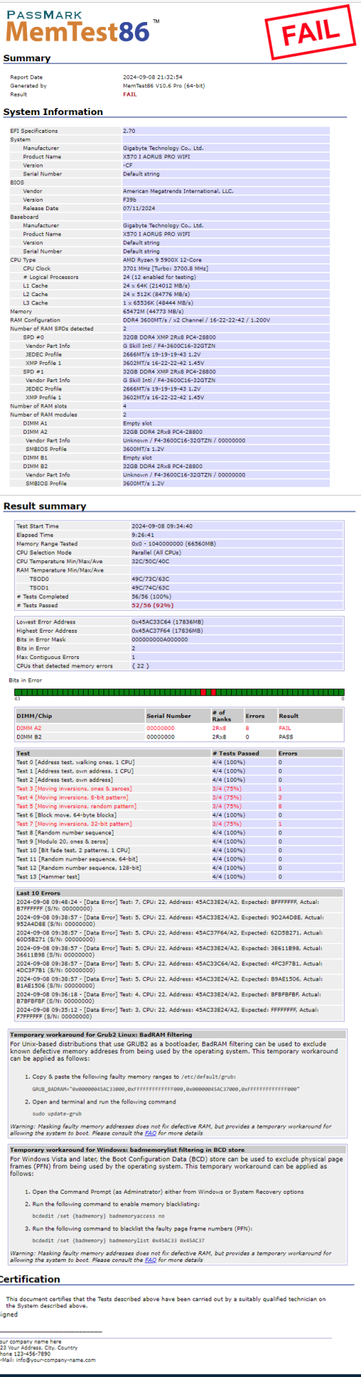

!3 Errors in each of 4 passes all found by CPU:22 ... Why always CPU:22
  • dcb
    • Sep 2024

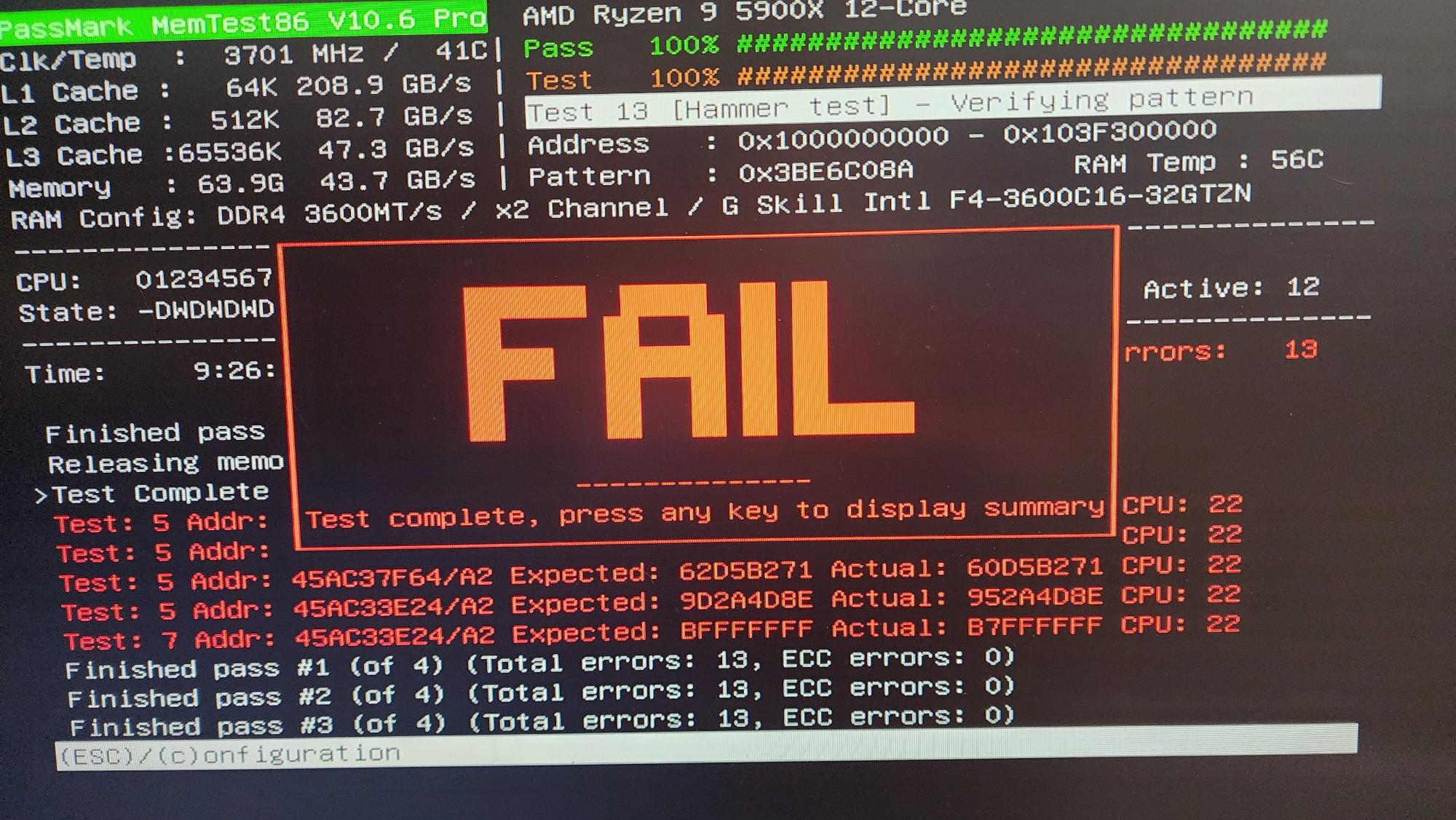

    FAIL.... So I believe I can safely assume the stick identified is bad, BUT WHY are the errors always found by CPU: 22?
    I this something significant, are there any possible issues with the CPU
    The documentation does not seem to address this, unless I missed it..
    • 11127
    Yes, looks like the A2 stick is bad.
    CPU:22 refers to the 22nd CPU Core. The terminology isn't great in the report.
    Part of the explanation might be that when testing in multiple threads, each threads works on a different area of memory and if the memory fault is always in the same small address range, then it makes sense that only that CPU can find the error.
    Interesting test would be to go into the settings of MemTest86 and limit testing to 8 threads / Cores. Then retest.
