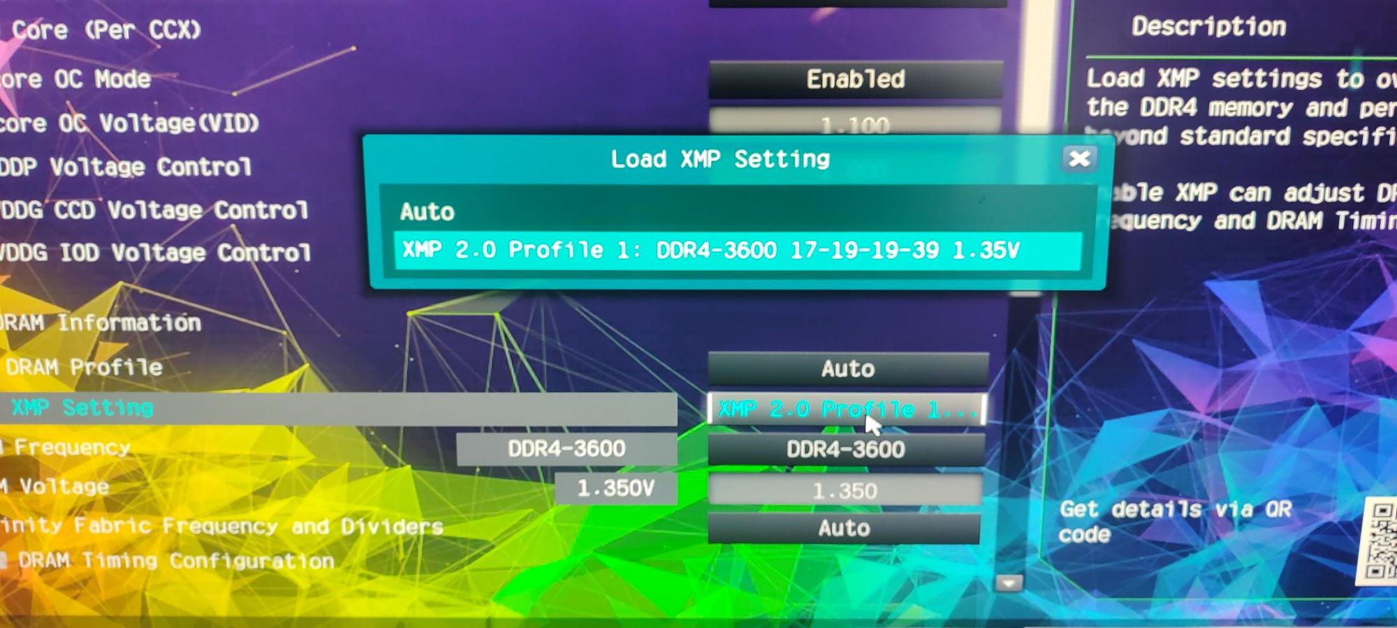

    In the BIOS, the memory was set to:
    XMP 2.0 Profile 1. 3600 17-19-19-39 1.35V​

      Thank you for your answer.
      In the first post I wrote that in BIOS the memory was set to: XMP 2.0 Profile 1. 3600 17-19-19-39 1.35V
      But the "Gear Down Mode" settings were on auto and the BIOS did not change to CL17 and it was CL18.
      I changed "Gear Down Mode" to "Disabled". Now 17-19-19-39 is visible in MemTest86.​

      MemTest86 uses whatever setting you set in BIOS. (3600MT/s / x2 Channel / 18-19-19-39 / 1.200V, it seems)
      in BIOS the voltage for the memory is set to 1.35V.​
      BIOS-DRAM configuration
