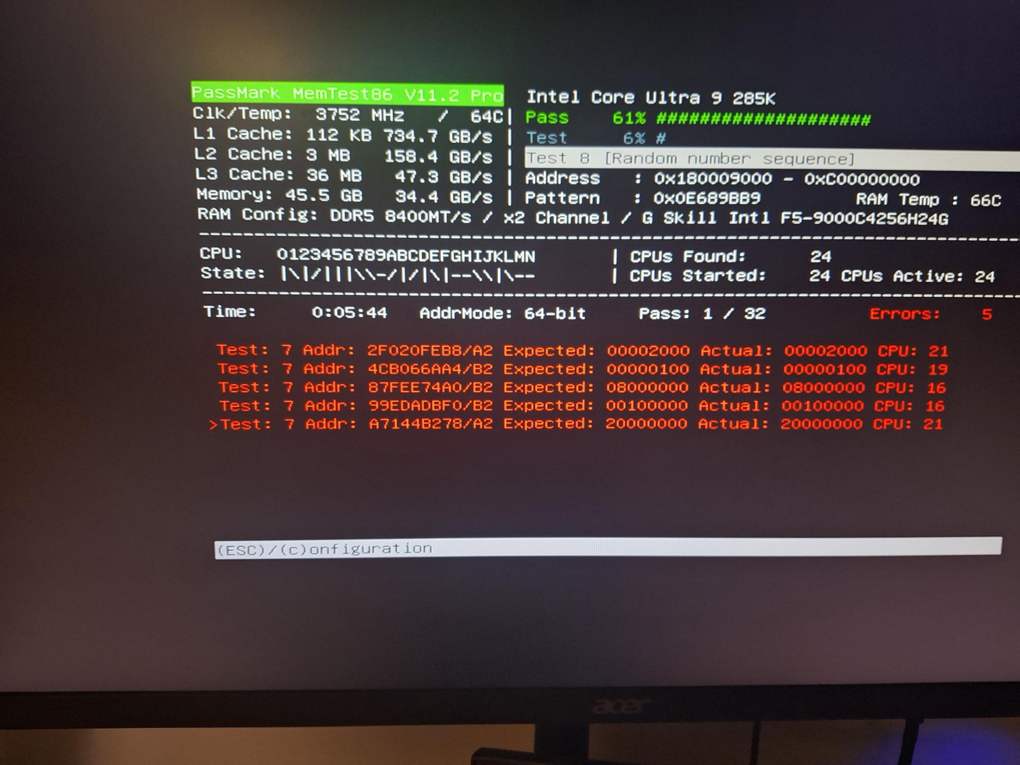

    What is this??? - Actual and expected value are the same
    2025-04-25 03:34:08 - [MEM ERROR - Data] Test: 7, CPU: 16, Address: 4BD574650/A2, Expected: 00000040, Actual: 00000040
    2025-04-25 03:34:08 - [MEM ERROR - Data] Test: 7, CPU: 19, Address: 4C8113CA8/B2, Expected: 00000200, Actual: 00000200
    2025-04-25 03:34:14 - [MEM ERROR - Data] Test: 7, CPU: 16, Address: 51D224888/A2, Expected: 01000000, Actual: 01000000
    You report an error even when the actual is the same as the expected???
    My faith in Memtest reliability is dropping sharply atm... Please explain...
    Yea, that is kind of strange.
    Could be that the CPU, or CPU cache, failed. (i.e. the CPU compares, for example, the value 8 with the value 8 and finds they are not the same value, somehow....).
    Or the value in RAM is intermittently wrong. For example the value used for the compare step was different from the value used for the print step.
    Can you Email us or post the debug log. Maybe there will be something interesting in the log.

            My hair is getting pulled out again. Is this a real error or is it not?
              99% sure this is a real hardware error.
              The cause of the error is less sure (bad CPU, address bus, RAM timings, RAM itself).

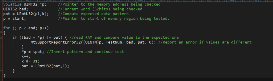

              The way computers work is that data from the RAM is moved from main RAM into the CPU's cache (of which there are several levels), and then from the CPU cache to the CPU's internal "registers". Once in the registers an compare instruction is done to check if the value is the expected one.
              This is the actual code of Test #7 (below).
              The key line is this one,
              (bad = *p) != pat
              This likely compiles to something like this in x86 assembly.
              mov eax, <pat>; Load a 32-bit pattern into EAX register
              cmp eax, *p ; Compare EAX with the 32-bit value in memory
              je equal ; Jump to 'equal' if EAX == [num_in_ram]
              One of these 3 instructions fails .... somehow.

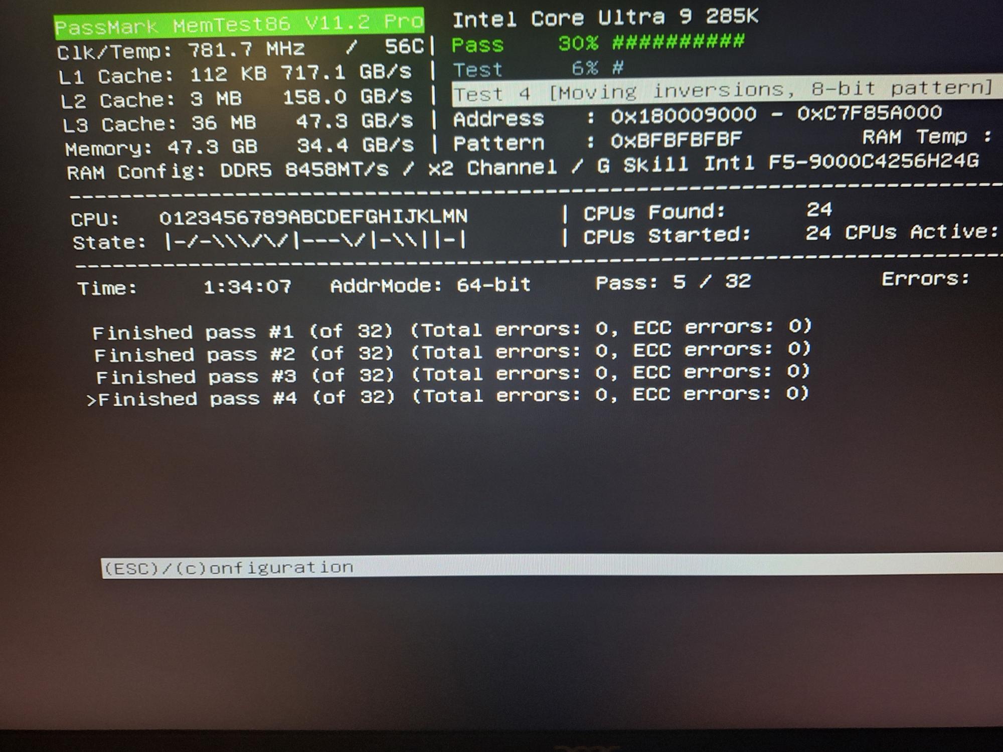

                        I did some more testing and found this...
                        Now. I was able to get the system stable. It passes Memtest all 4 passes, but I have a question or two...
                        Number one is that I think the main stat is the Memory (line, 5th one down) <amount> and the speed. I also assume that the higher that speed is, the better.
                        Number two... Is 34.+ be fast, you have seen way more of these screens then I have. I think it is but have nothing to compare it to.
                        Number three, what is up with the reported CPU speed? I am pretty sure that I am running way faster than 781 MHZ...
                          What did you do to get the machine stable ?
                          Yes, higher GB/sec is better than lower. 34GB/sec is OK.
                          (we've seen results as high as 60GB/sec, but that was with RAM / huge cache on board with the CPU die, like with the Ryzen 9 7950X3D, so maybe not a fair comparison)
                          That was the measured speed. But CPU clocks speeds ramp up and down from one millisecond to the next.
                          We try and report the max clock, but it can be hard to force the CPU into it's highest clock speed state.
                          • Roxxors
                            • Mar 2025
                            • 57
                            To get it stable I bumped the BCLK from 100 to 126 and enabled BCLK aware voltage then set the memory controller voltage manually from 1.1 to 1.5v after bumping the SOC from 100 to 106.
                            It's kinda like playing Whack a Mole.
                            If I increase A and B, system locks.
                            If I decrease A and B, system is slow.
                            If I increase A and drop B down, system runs at speed X.
                            If I increase B and drop A down, system runs at speed Y.
                            So I just see which combination is faster and more stable over all.
                            Thing is that it's just not settings A and B, there are like 50 different settings or more and an almost millions of combinations and finding the fastest and most stable one is gonna take time...
                            I may just die of old age first...
