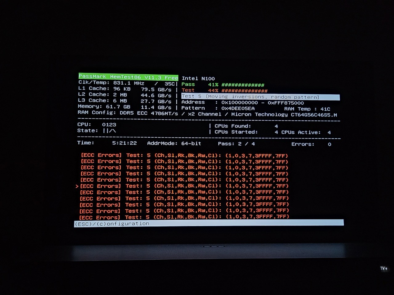

          Hello !
          I have the exact same issue but on an Intel N100 (Alder Lake N platform)
Name:	20250626_233232 Large.jpg
          On this computer, I use In Band ECC which is an ECC method using actual memory instead of ECC sticks.
          If I disable In Band ECC in the BIOS : no error
          With In Band ECC enabled in the BIOS and memtest86+ : no error
          Given the error is always at the same address, and at the top upper bound, I wonder if it's an issue in the ECC polling of memtest86.
          Apparently, the developers of the Linux EDAC driver (driver for ECC error monitoring) encountered the same issue on this platform !
          Polling the ECC register would return a value of ~0 (0xffffffff) and flood error messages
          This really seems that's what happen in memtest86 (especially given the memory address at the upper bound !)
          They solved this by clearing the register.
          You can see the git diff on the driver here : https://github.com/torvalds/linux/co...b6f15aca57da92
          This would be very nice to fix that !
            Yes, that is what the MemTest86 log showed. All F's. Which resulted in false positives on the unpopulated memory slots.
            ECC RAM has been around for 50 years. It is pure insanity that Intel and the other CPU vendors still can't agree on a standard for handling ECC RAM and new code is required to be written for each CPU family.
            codingfou​, I've sent you a private message in the forums here, with a link to a new built to try (we don't have a N100 CPU to test with).
            • codingfou
              • Jun 2025
              Hello
              I have tried the new build today and it fix the issue
              Thanks !
