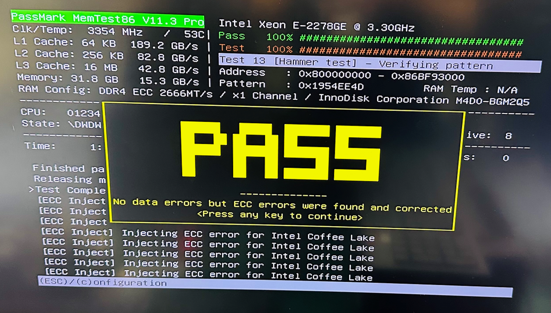

                We have another platform with ECC injection test. It reports a yellow PASS message. It also reports ECC errors were found and connected.
                I'd checked the manaul. It means corrected ECC errors were detected. How to identify the corrected errors is real errors or a simulation in ECC injection test?

                  Yes, the Yellow pass message means that there were no errors that were not corrected.
                  The easy way to tell if you have real ECC corrections (as compared to corrections of the deliberately injected errors) is to turn off the ECC injection option.

                    I ran MemTest86 ECC injection enabled and disabled with innodisk and Transcend DDR4 ECC SO-DIMMs.
                    For ECC injection disabled in MemTest86, the results of are the same. I have green PASS results.
                    For ECC injection enabled in MemTest86, I have different results. I have a green PASS result for Transcend SO-DIMM and a yellow PASS result for innodisk SO-DIMM.
                    Based on the results of innodisk SO-DIMM, the errors seem to be injected by MemTest86 and they are corrected and reported on the screen.
                    For Transcend SO-DIMM, the errors are injected and corrected? Why have different results from different SO-DIMMs?
                      Thanks for the logs.
                      When ECC injection was enabled, the logs seem to indicate that the ECC injection functionality was disabled and locked by the BIOS. So it was surprising to see that ECC errors were being detected for the innodisk SO-DIMMS.
                      Also, it was strange to see that only ECC errors were detected for the innodisk SO-DIMMS during the first 3 tests. When ECC injection is enabled, it should perform the injection at the beginning of every test. So if the ECC errors were the result of ECC injection, I would expect to see more errors being detected in subsequent tests.
                      For the Transcend SO-DIMMs, there were no ECC errors detected so ECC injection didn't appear to work. This is why the result was a green "PASS".
                      I can see that the CPU/motherboard for these tests are the same, but is it on the same physical system? (ie. did you run the test on different machines or simply just swap the SO-DIMMS for the test)
                      Have you tested on other SO-DIMM models other than innodisk/Transcend? It would be curious to see if there is any other model other than the innodisk modules that triggers the ECC errors.

                        I ran 5 more DDR4 SO-DIMMs with ECC injection enabled in MemTest86. I found the same result (Yellow PASS) at Transcend TS4GSH74V6E-I 32GB DDR4 2666 ECC SO-DIMM as innodisk SO-DIMM. Others reported the green PASS.

                          It appears that only the 32GB modules resulted in ECC errors (ie. yellow "PASS"). For these modules, were there ECC errors detected (ie. green "PASS") if you disable ECC injection?

                            I ran the test build, 11.3.1013, with MemTest86 ECC injection disabled at 32GB module. The result is a yellwo PASS.
                            Without ECC injection, it still can correct the errors. We could say the correction function is workable.
