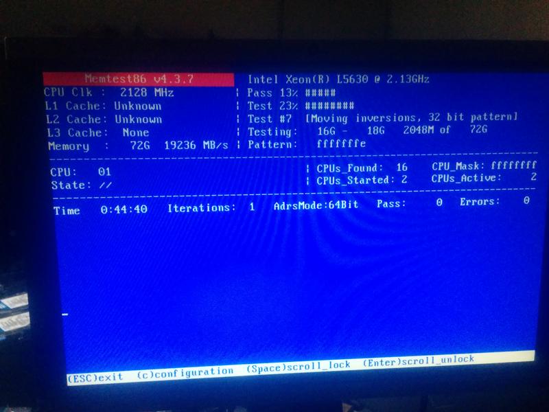

    Hi i have memtest86 4.3.7 and testing 72gb, 8 sticks each of 8 gb using dell t5500 workstation using dual L5630 processors in parallel mode but instead of using 16 threads/8cores it is just using 2 cores.
    Even if I remove second processor from system it just shows one core instead of 4 cores in parallel mode
    I am using latest a16 bios.
    It's not UEFI system.
    Hyper threading and virtualization enabled.

        I also noticed that memtest hasn't detected L1, L2 cache
        • #5
          I resolved it by disabling limited cpu id option in bios under performance.
          But with hyper threading enabled instead of 16 threads it is using just 8.
          Is it normal and ok?
          • #6
            Enabling the 'Limit CPUID' option will prevent MemTest86 from obtaining the necessary information regarding the number of CPU cores/threads, so it makes sense that disabling it would fix the problem.
            MemTest86 can only run on physical cores and not hyperthreads so yes it is normal to see the number of CPUs running is less than the number of CPUs found.
