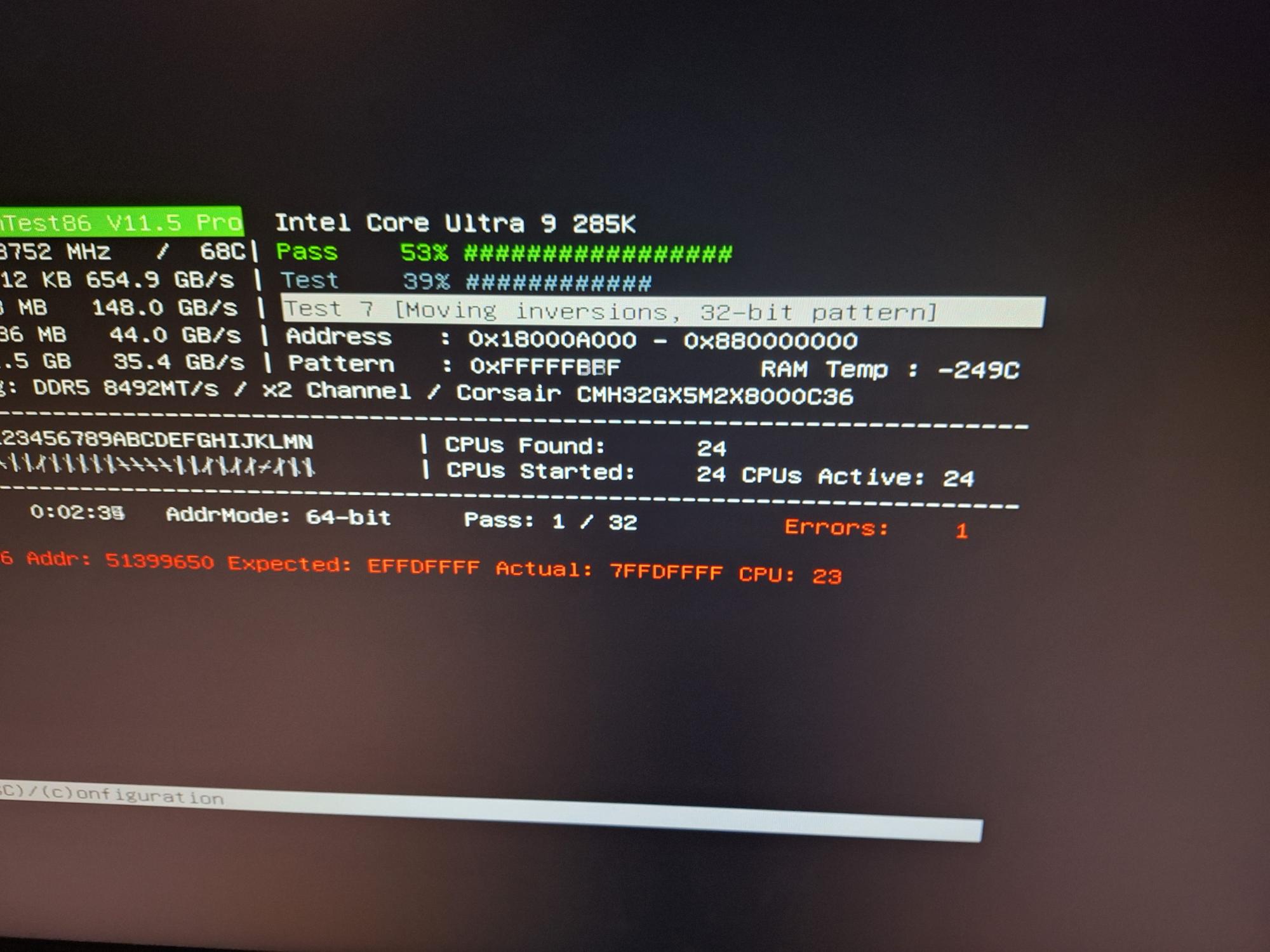

      Now I get this... first it was 188C, fixed that, now -249C. My apartment is freezing... BTW, just tossing it out. I used to get this all the time if I tried to copy an unsigned var into a signed var (or the other way around) without the (cast) in front of it...​ Click image for larger version  Name:	20251026_231619[1].jpg Views:	0 Size:	233.7 KB ID:	59965

        #18
        If possible, can you send a copy of the MemTest86 logs as before.

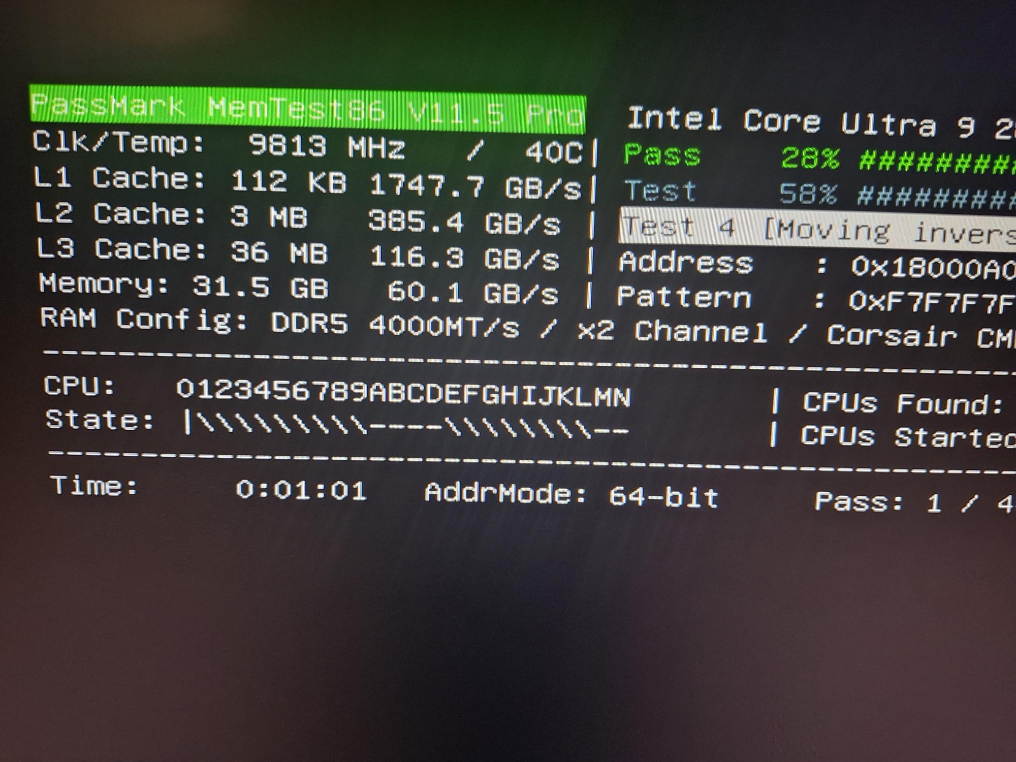

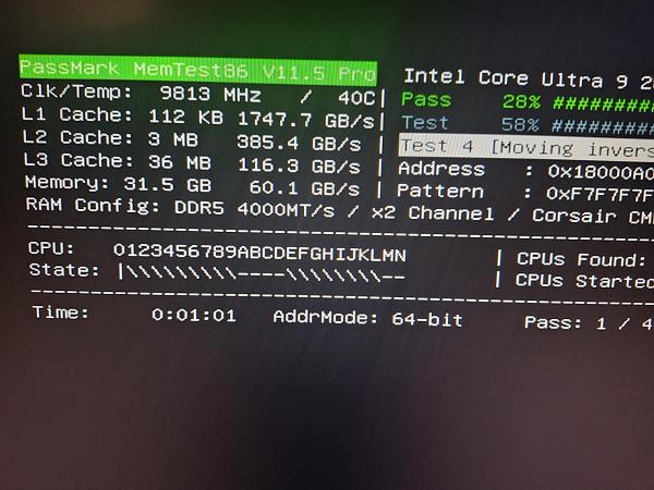

              Just so you know, I get all kinds of weird and odd stuff...I don't think my CPU is running at 9800mhz and there is no way that you could possibly hit 60GB/s at 4000MT/s... Click image for larger version  Name:	20251011_012707[1].jpg Views:	0 Size:	309.4 KB ID:	59975

                  #23
                  According to the logs, it seems you are using the public build but the tempreature fix was made after the release. Can you see if the debug build we sent previously has the temperature issue.
                  (the bug, that was fixed, can cause the temperature to be random, positive or negative on a few systems)
