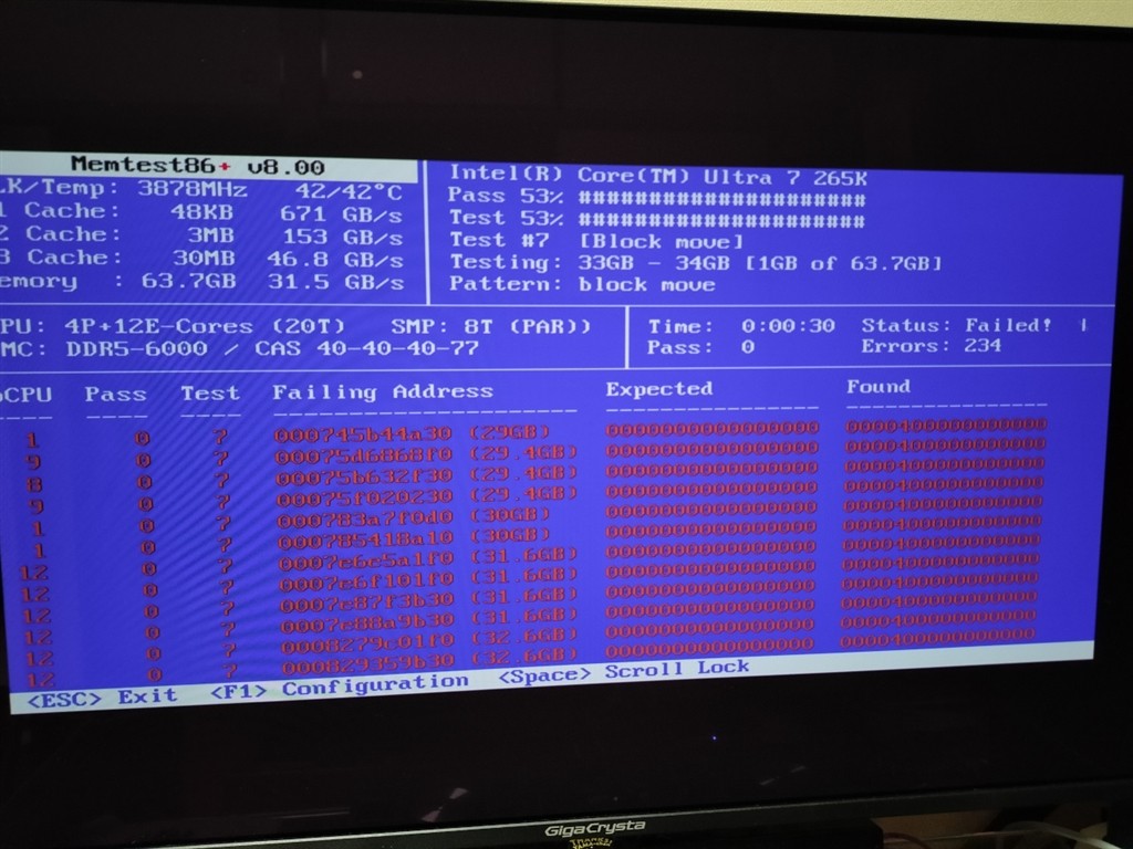

          • foobar
            • Jun 2026
            i saw similar failure on test7 block move (movs) with memtest86+ v8.00.
            Issue solved when D2D clock was set to 29 instead of 32.
            200S boost offers better performance without voiding hardware warranty, but it's not guarantee system stability.
            Verified system: Z890 LiveMixer WiFi BIOS 3.21/ 265K/ CMK64GX5M2B6000Z40 *2 = 64GB
