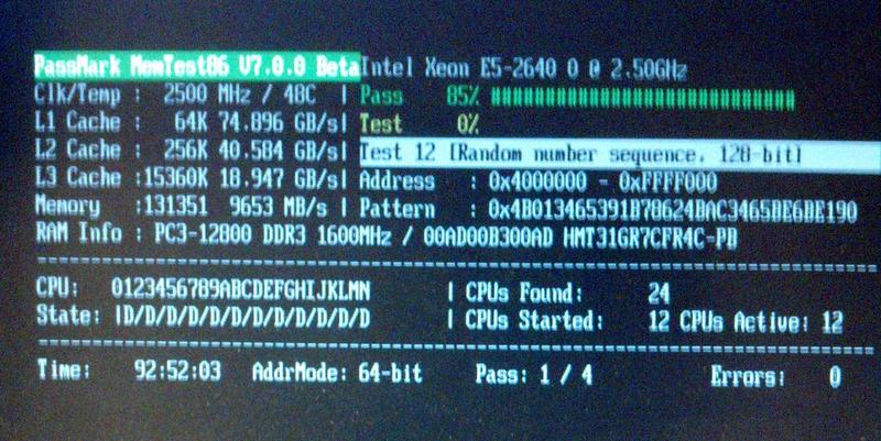

    ... on a Dell PowerEdge R720 with 128 GB PC3-12800R RAM after 93 hrs:
    However, after ESC'ing out and selecting 'Skip the current test' it continues with Test #13 fine.
    Do you have the logs for this run?
    Is it reproducible?
    If so, can you e-mail the MemTest86.log under EFI\BOOT\ of the USB drive to us.

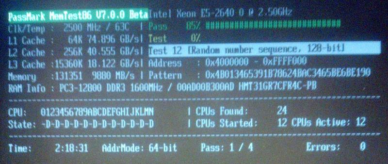

      Unfortunately I have no log since Memtest booted from CD-RW. I'll check if I can re-create the issue by using UFD and then just start test 12.
      • bcs
        • Jul 2016
        • 7
        I was able to reproduce it. Here's a screenshot from this morning:
        Notice how it stalls at the exact same Address and Pattern as yesterday.
        Edit: Also contrary to what I wrote earlier I didn't just run #12 for this second test, but instead I ran the full test.
        I'll e-mail the logs. Thanks for looking into this.
