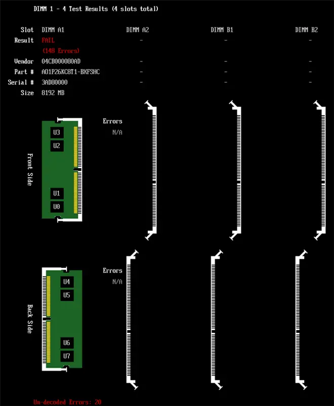

How to identified which DRAM IC defective
  • DenT
    • Aug 2026
    We recently purchased MemTest86 Pro v11.7 to perform memory testing. Could you please advise on how to identify which DRAM device or DIMM is defective when memory errors are detected during the test?

    See: https://www.memtest86.com/tech_DIMM_Decoding.html
    Note that DIMM/Chip decoding is only supported for certain motherboards, memory and CPU architectures
    https://www.memtest86.com/tech_DIMM_...rted-platforms
    Chip decode is only available in site license
    Theres only one DIMM in your screenshot?

      Yes, we testing one dimm and see the result can detect which DRAM defective. My memtest86 not site license?
      ​​​​​​Attached with the MemTest logs
      MemTest86-20260723-071921_325937.log
        The Chip decode level is only available in site license.
        Generally home users & small business users don't care which specific chip is bad on a module, as they can't be repaired or replaced, except at specialist facilities.
