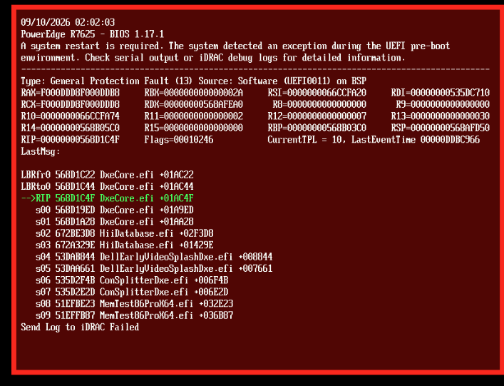

    The crash is a Dell UEFI firmware exception, not a MemTest86 reported memory test failure.
    Strangely the timestamp showed this happened 5 months ago??
    Faulting instruction was in the EFI software, DxeCore.efi at address 0x02E085
    DXE = Driver Execution Environment.
    Call path was:
    DellEarlyVideoSplashDxe.efi called
    HiiDatabase.efi which called
    DxeCore.efi which crashed
    There are multiple similar crash on the Dell web site:
    https://www.dell.com/community/en/co...ccf8a8de29c346
    https://www.dell.com/community/en/co...356218a14fb217
    https://www.dell.com/community/en/co...ccf8a8de49fe86
    You might need to get Dell involved to debug their BIOS.

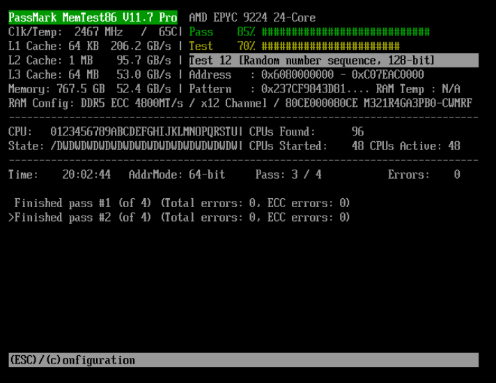

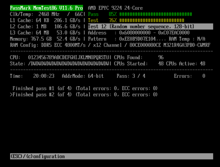

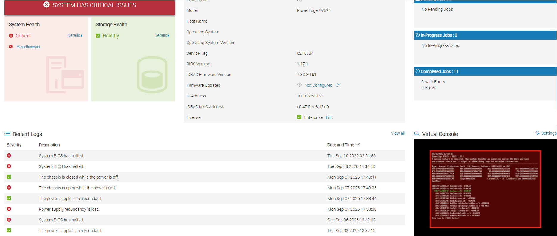

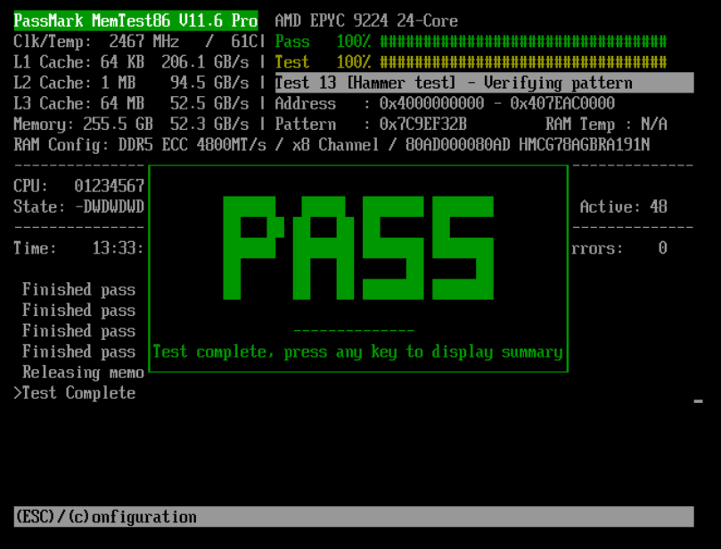

          I have an additional finding that may be relevant to this issue.
          As mentioned previously, we started testing a previous-generation Dell PowerEdge R7625 with AMD EPYC 9224 (Genoa) for comparison with the R7725 / EPYC 9335 (Turin) systems.
          Initially, the R7625 appeared to be stable. However, after extending the test duration, we found that MemTest86 also hangs on the R7625, although the behavior is different from the R7725 UEFI General Protection Fault.
          We tested both:
          • MemTest86 Pro 11.6 — 2 attempts
          • MemTest86 Pro 11.7 — 2 attempts
          All four attempts eventually hung, at approximately the same stage of the test. Dell PowerEdge R7625 configuration
          • Dell PowerEdge R7625
          • Dell PowerEdge R7625 Motherboard V4
          • 2 × AMD EPYC 9224 2.50 GHz / 24-core
          • 24 × Samsung 32 GB DDR5 RDIMM 4800 MT/s (768 GB total)
          • 6 × Dell R7625 Very High Performance Fans
          • Standard heatsinks for 2-CPU configuration
          • Dell E810-XXV 2×25Gb SFP28 OCP 3.0 Intel

          The server firmware is also up to date. MemTest86 11.6
          In one of the reproduced hangs, the screen remained at:
          Time: 20:00:23
          The MemTest86 interface was completely stuck at this point and no further progress was observed. MemTest86 11.7
          We then repeated the test using the current MemTest86 Pro 11.7 release.
          It hung in almost exactly the same place:
          Time: 20:02:44
          Again, passes #1 and #2 completed successfully with zero memory and ECC errors before the hang.
          We have reproduced this behavior twice with 11.6 and twice with 11.7. The hangs occur at approximately the same stage, after around 20 hours of testing.

          I have attached screenshots from both the 11.6 and 11.7 R7625 runs.
          Given that we are now seeing reproducible long-duration issues on both AMD EPYC 9004 (Genoa) and AMD EPYC 9005 (Turin) Dell PowerEdge platforms, could there be a known limitation or compatibility issue with MemTest86 on these newer AMD EPYC generations, particularly in dual-socket systems with large DDR5 memory configurations?
          The fact that the R7625 hangs at nearly the same point in Test 12 on both MemTest86 11.6 and 11.7, after two complete error-free passes, seems particularly interesting.

            Additional test result with a smaller memory configuration on the same R7625 platform
            I have another result that may help narrow down the R7625 issue.
            We tested the same Dell PowerEdge R7625 / AMD EPYC 9224 (Genoa) platform using a smaller memory configuration with 16 GB DDR5-4800 RDIMMs (Hynix).
            With this configuration, MemTest86 Pro 11.6 completed all 4 passes successfully and did not hang.
            This suggests that the R7625 hang may be related not simply to the Genoa platform itself, but possibly to the memory capacity, number of DIMMs, DIMM topology, or the specific Samsung 32 GB RDIMM configuration.
            The fact that the smaller Hynix configuration completes MemTest86 11.6 successfully while the 24 × 32 GB Samsung configuration reproducibly hangs in approximately the same place seems significant.
            I have attached the screenshot showing the successful MemTest86 Pro 11.6 run with the smaller memory configuration.Click image for larger version

                This time it did not remain as a simple MemTest86 hang. The server displayed an actual Dell UEFI exception:
                PowerEdge R7625 - BIOS 1.17.1
                Type: General Protection Fault (13)
                Source: Software (UEFI0011) on BSP
                and iDRAC recorded:
                System BIOS has halted.
                Therefore, the behavior we initially described as a simple MemTest86 hang on the R7625 can eventually progress into the same general class of UEFI failure that we observed on the R7725.
                2. The R7625 UEFI stack now also contains MemTest86ProX64.efi
                The R7625 exception stack includes:
                DxeCore.efi
                HiiDatabase.efi
                ConSplitterDxe.efi
                MemTest86ProX64.efi
                The fault itself is again reported in DxeCore.efi.
                I will attach the complete exception screen so you can examine the exact addresses and call stack.

                In particular, given that the R7625 stack contains MemTest86ProX64.efi, ConSplitterDxe.efi, DellEarlyVideoSplashDxe.efi, HiiDatabase.efi, and DxeCore.efi, it would be very useful to determine whether MemTest86 is repeatedly invoking a particular UEFI service or allocating some UEFI resource that is not being released.
                We can reproduce the issue and are happy to run an instrumented/debug build if one is available.

                      UEFI exception screen is present on the locally connected physical monitor as well
                      I'm proposing not using remote UEFI console at all. Turn it off.
                      Especially as the stack trace showed the fault was in the video and text / font handling. (HiiDatabase.efi refers to the Human Interface Infrastructure (HII) font handling in UEFI). And these functions are exactly the type of functions that would need extra code for remote console.
                      Unless Dell are involved I think it pointless to try and isolate what provokes their bug. We could spend weeks narrowing down the cause, only for them to continue to ignore it.
                      (plus if they were involved they can determine the location of the crash in 10min, from the crash address, saving us weeks of work)
