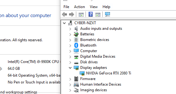

                  I am having a similar issue. I am going through your online training program and brute-forcing the encrypted Word-Docx file in the Sample Files directory provided in your online training program.

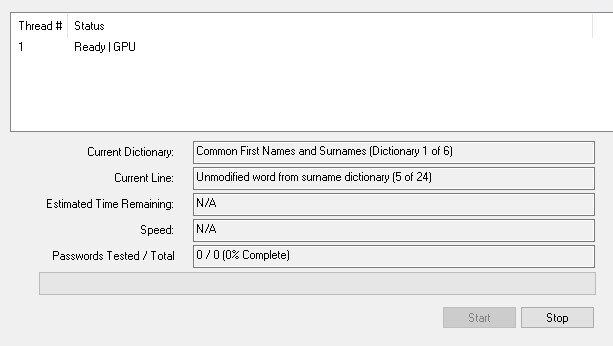

                  I selected four dictionaries and GPU for processing the encrypted file. I have an i9-9900K CPU and 64 GB of system RAM with an ASUS Strix GeForce RTX 2080 Ti (11GB RAM) video card using the latest graphics drivers (456.55) from Nvidia and it appears (see screenshot) the GPU was not utilized in the brute force attack.

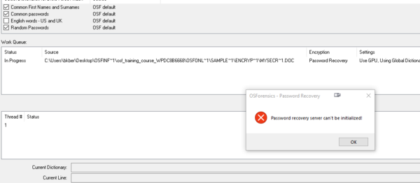

                      I now received an error message which I didn't get yesterday. The error message, "Password recovery server can't be initialized!
                      I then uninstalled both versions 7 & 8. I reinstalled v7.1.1012 and ran it in debug mode. I then tried it again and received the same error.

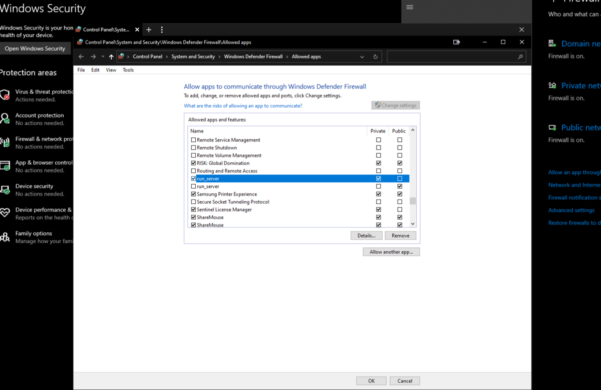

                      I did check my system firewall settings which appear to be correct. See screenshots and logs for more details.

                        The GPU is only used when the decrypting using the Random Passwords dictionary. From your first screenshot, it looks to be working through the Common Name dictionary set. Can you disabled all other dictionaries and test just using the Random Password selected to see if the GPU is used.
                        Regarding the second screenshot, the server failed to start, error could be caused by an existing instance of "run_server.exe" is already running. You can verify by bringing up the Task Manager and looking for zombie run_server.exe instance. Either restart the machine or you can kill process and see if the decrypting will start afterwards. Also note, that in the Trial/Free edition, you are also limited to 1 decrypting thread.

                          I ran OSF v7.1.1012 (Licensed) after a fresh restart in debug mode. I selected one dictionary (Random Passwords), selected the training Word-docx file for decryption, and received the error server can't be initialized. I verified through Windows Task Manager there were no zombie run_server processes running. I checked Window's firewall settings and it showed run_server.exe allowed (Private Network). However, I did discover when looking at my NICs that my network status was set to Public. I subsequently change the status to a Private Network. I then decided to make a second attempt in debugging mode. Unfortunately, it failed again. I did see some differences in Task Manager.
                          I then decided to reboot and make a third attempt at the decryption. Unfortunately, I had the same results.

                              We tested V7.1.1012 on RTX 2060 and it went okay. It was a new install so we had to go into the firewall settings and enable both network types for run_server.exe. It seems the windows firewall was blocking it (despite the initial popup).
                              Looking at your screenshot, attempt 1, shows that it failed to start the server at all, while attempt 2, the server is started, but OSForensics timed out while waiting for it to respond it started. It might be something on your machine blocking the program? Some anti-virus program? The password decryption uses distributed method. There is a server that acts as the scheduler and then clients (CPU and GPU) connect to it to get jobs.
