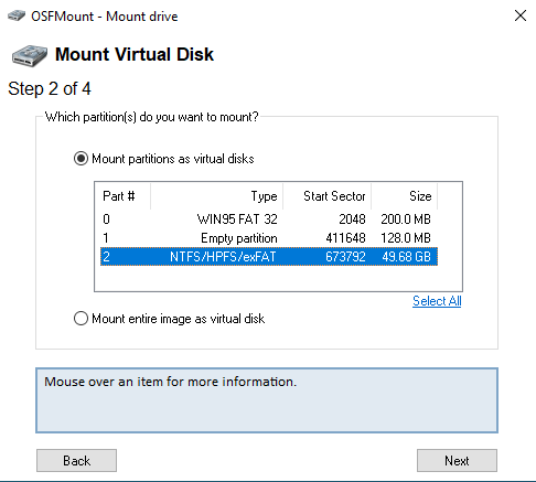

      +1 on this if the feedback goes into a feature request bucket. Being able to programmatically determine the number of partitions that are present on an offline disk would be useful for detecting only the partition(s) that need to be mounted. In my case, I'm trying to read a VMDK offline but the boot partition does not contain information that I need (I only need the NTFS partition, Forum in the screenshot).

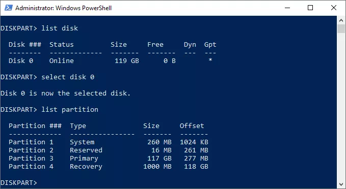

        Can you use the DOS / Powershell command, diskpart for this?

          Thanks! diskpart.exe would definitely work - I was actually planning on creating an array of drive letters with PowerShell before/after running "OSFMount.com -a -t file -f my.vmdk -v all" so I could keep track of what I need to clean up after I'm done reading the disks. I was hoping to not have to mount all volumes in the VMDK and instead mount only volume I need, but I don't know which one I need until they are mounted.
