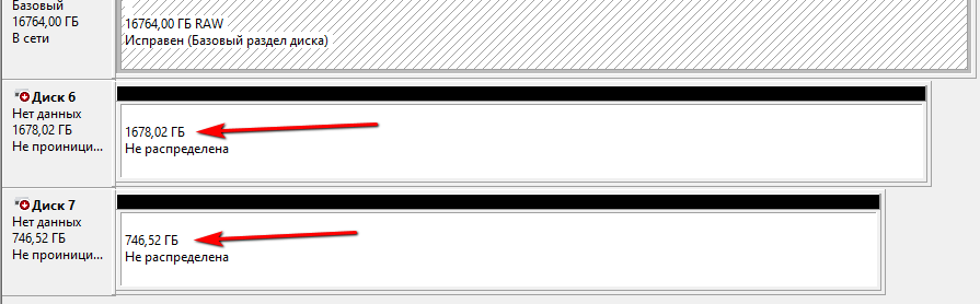

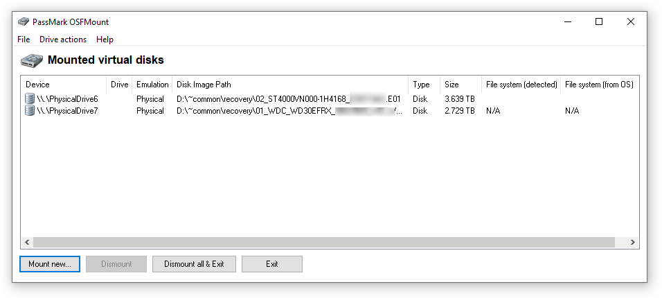

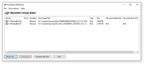

          I can confirm the issue with large E01 images.
          On the pictures below you can see two "physically" mounted disk images (4TB and 3TB) which are recognized by Windows as 1678,02 GB and 746,52 GB harddisks respectively.
          They are part of RAID6 set so RAW/unallocated space is generally fine.
          Disk images were taken with Guymager (3TB) and FTK Imager (4TB) with best compression option, got nearly the same effect.

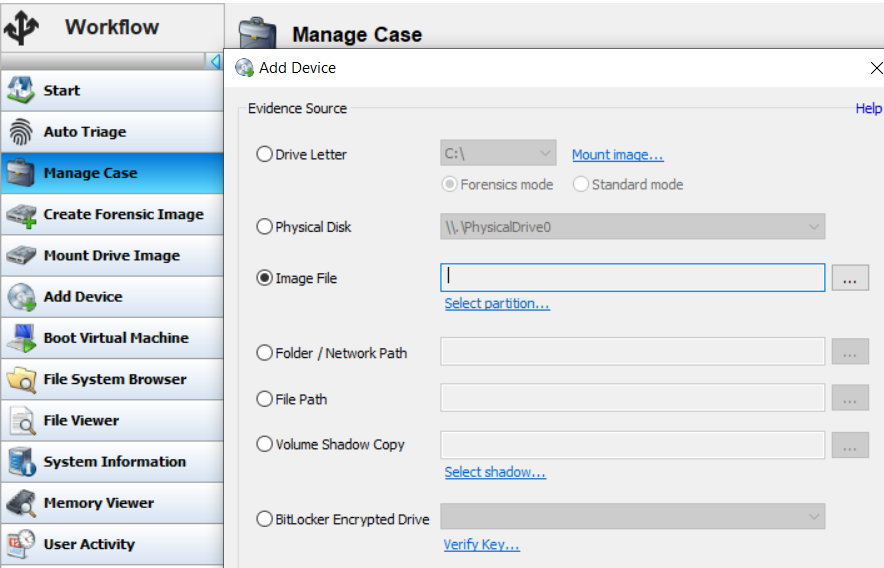

            Thanks for letting us know. We suspect it may be related to issues we found related to Encase images.
            If possible, can you use our OSForensics tool (which we have made fixes to reading Encase images) and see if you can load the large Encase images.
            https://www.osforensics.com/download.html
            If we can confirm it works OK, we can apply the same fix to OSFMount.

              The OSForensics v8 loads my images and I can verify them successfully.
              However, I see no entries in RAW disk browser and cannot browse files (which seems logical as my images contain no partitions except split 16TB GPT from ofiginal 8-disk raidset).
              Are there any requirements to the test image and specific actions to check for me in OSF?

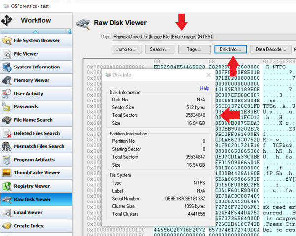

                  If you select the image in Raw Disk Viewer and select Disk Info, you can verify whether the total sectors and size of the disk is correct.

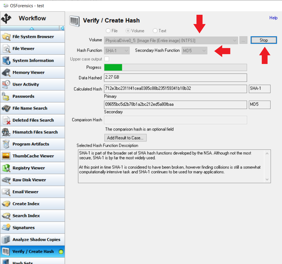

                  In the Verify / Create Hash module, you can calculate the disk hash to verify the integrity of the disk (if you have the hash of the original disk stored somewhere).
                  However, since the disk is large it might take a while to complete.

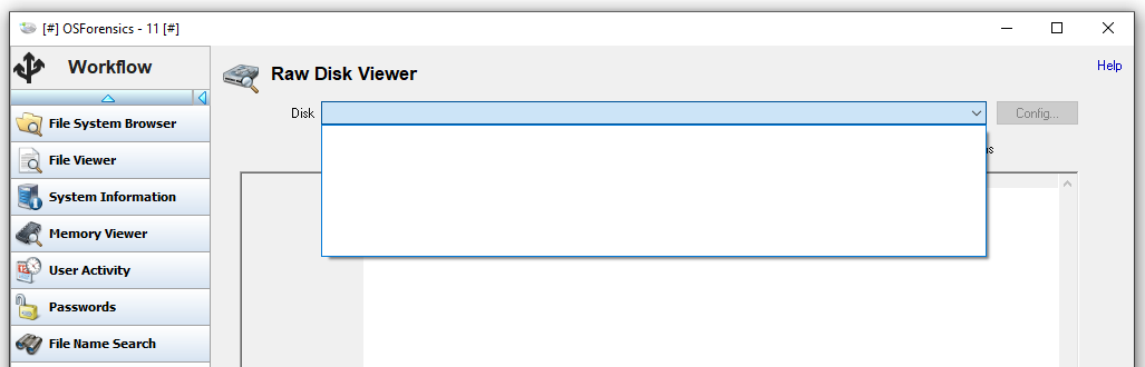

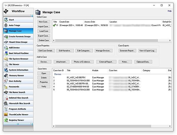

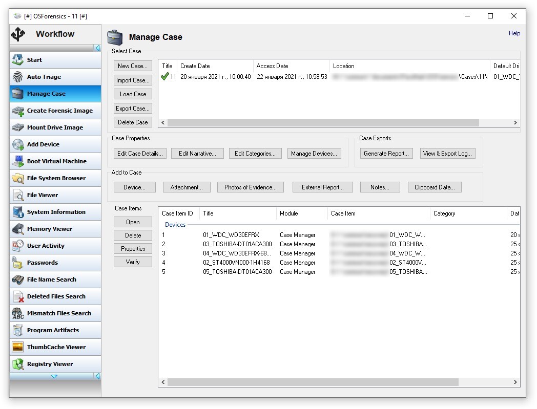

                        OK, I added 5 images which I made so far as "entire disks" and none of them is available in RAW disk viewer. Image checksum verification passses succesfully in "Manage case" tool.
                          Are you running OSF with administrative privileges?
                          The above may happen if you run without admin rights.
                          What also might help is running in Debug Mode and uploading a copy of the log file.
                          OSForensics - Tutorial - Running in Debug Mode

                            In elevated UAC mode I see all my images and RAW disk browser shows correct disk size for each image.
                            "Verify/Create Hash" passed on first disk, I'll check the rest in a few days.
                            • Vald
                              • Jan 2021

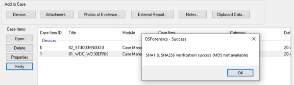

                              Finaly, all five Encase images passed checksum validation in OSF via "Verify/Create Hash".
                              All good.
