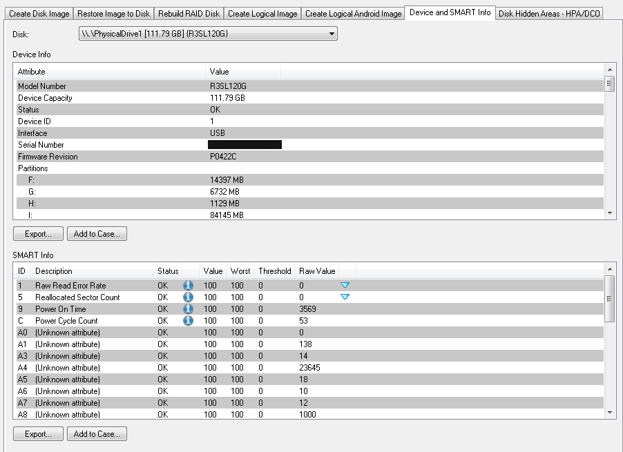

            As you see, SMART of both drives are OK.

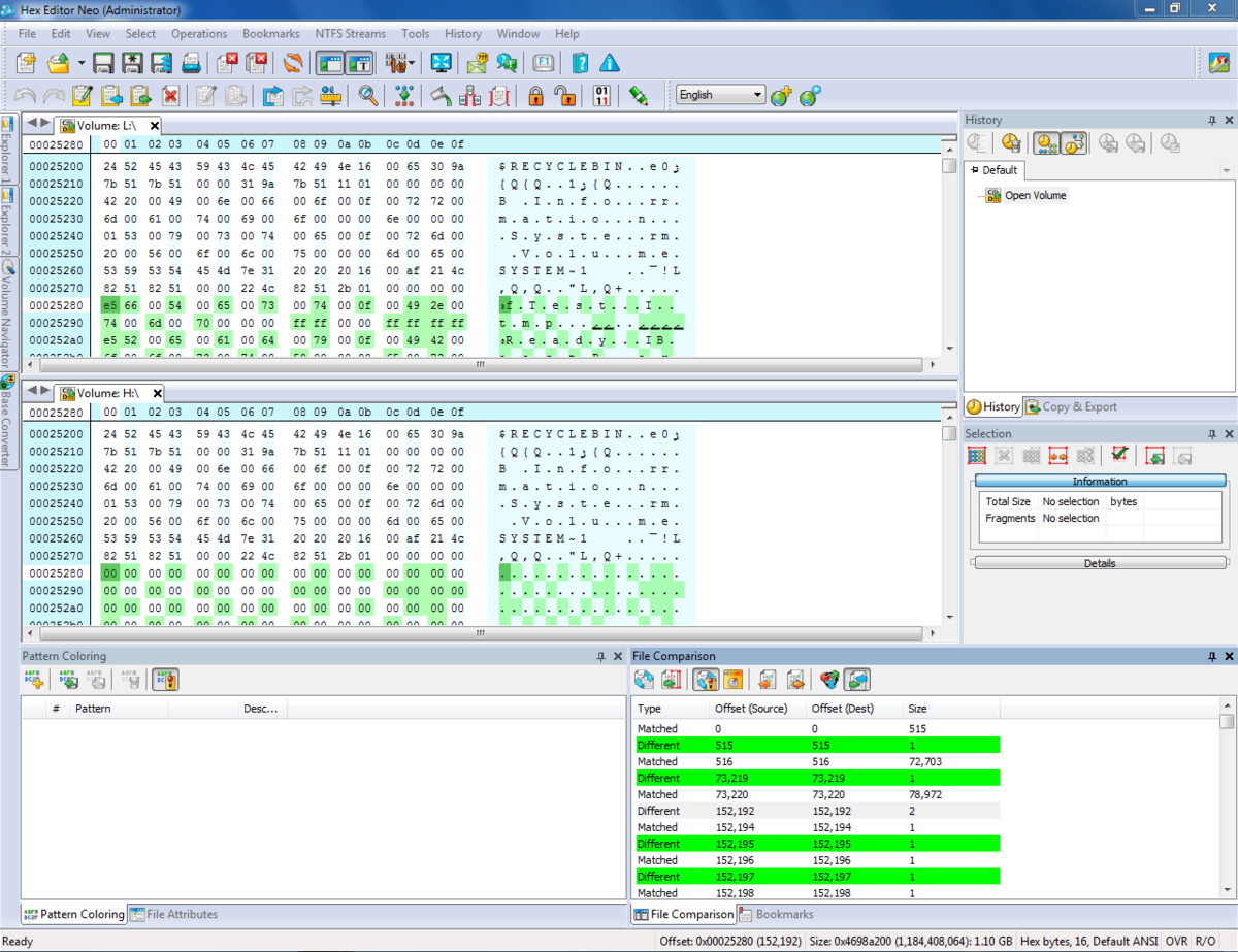

            2- Drives have same hashes, but why when I compare two volumes with "Hex Editor Neo" tool, then they are different?

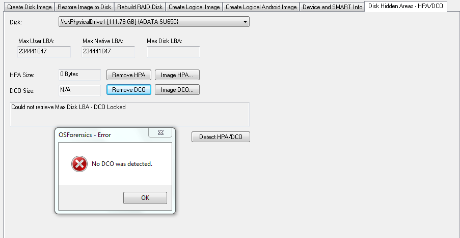

              DCO error:
                Impossible. Your methodology must be flawed. Maybe hashing the same drive twice, or the drives aren't write protected and you are comparing the hex values after additional data has been written to them (after computing the hashes).
                That DCO error was just saying that DCO can not be detected / altered on that drive.

                  #23
                  It is odd for me too, but it is true.

                          1- I used OSForensics for create this image and not "dd" tool.
                          2- Did you see the SMART screenshot of both SSD Drives? Both drives are OK.
