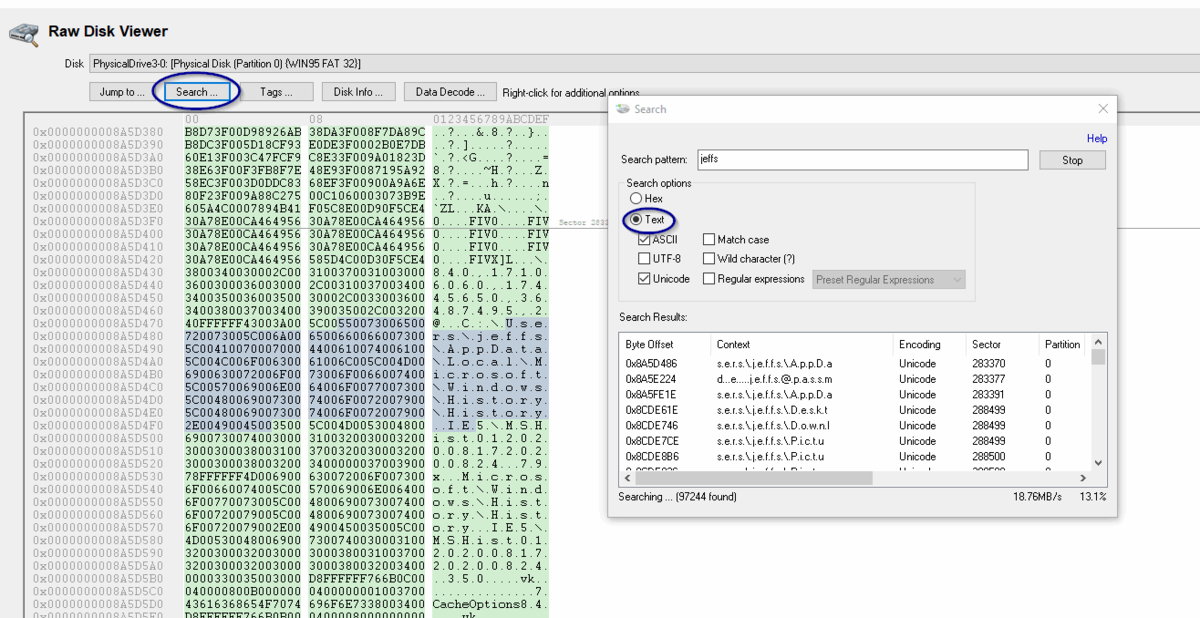

        Do you have the USB in question? If so, I'd start there. Connect to your machine; add the physical device to your OSF case; open it in the Raw Disk Viewer, then perform text search for the user accounts. You likely could eliminate some that may have never connected to the USB or perhaps be able to at least identify a few that had connected the device. Best case scenario, you find a match for only 1 user account. See screenshot.

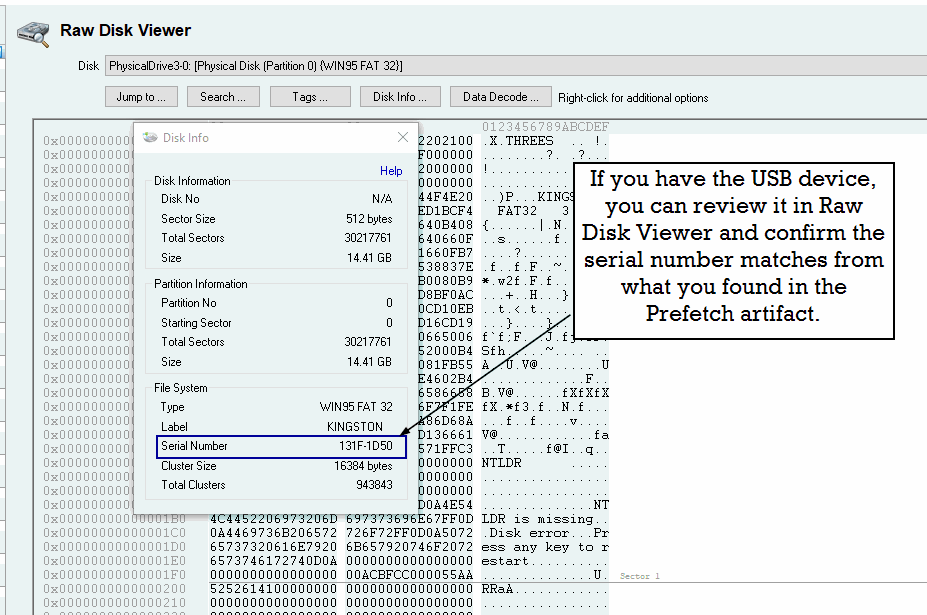

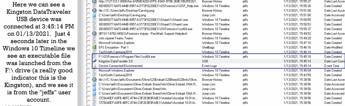

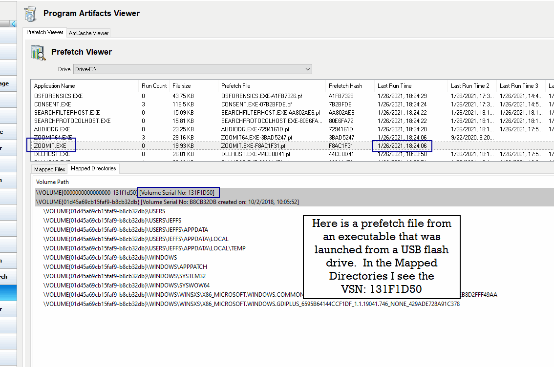

          One more thing... If an application was launched from the USB in question, review Prefetch artifacts and find when the app was last ran. Then review the mapped files and directories. You should be able to get the volume serial number of the USB device. You also should be able to find some other artifacts that will probably include file paths and will see the user account that was logged in at the time. If you have the USB drive, you can then look at the USB physical disk in the Raw Disk Viewer, and match the serial number. This way you could in theory prove the application was launched from that drive and when, and also make a pretty good determination which user was responsible. See attached.
Name:	USB Activity - Prefetch.png
Name:	USB Activity - Raw Disk Viewer.png
