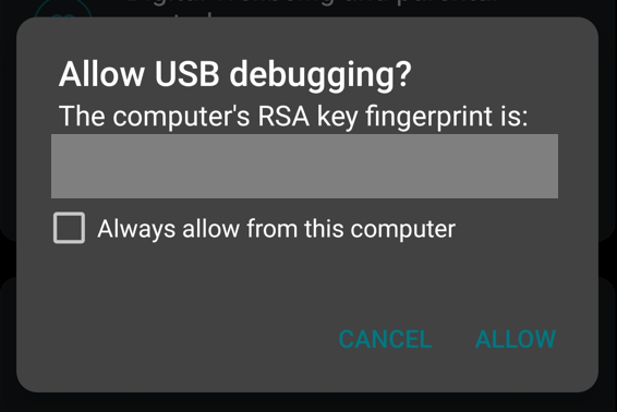

        • 337
        Did you have 'always allow from this computer' checked? Else you might need to allow separately for OSF.
        ​Click image for larger version  Name:	image.png Views:	0 Size:	47.0 KB ID:	53858
        If you still have issues, can you replace osf64.exe where you have installed OSF with the below linked:
        https://www.passmark.com/downloads/t...4_20221124.zip
        Which has some extra debugging, run OSF in debug mode and send us the generated log to have a look.
