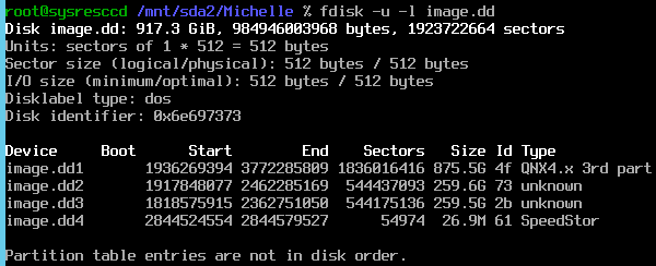

      I created a dd image with TestDisk and I can't figure out how to restore the NTFS Windows partition contained inside.
      I got the warning mentioned above but OSFMount mounted the NTFS partition just fine and I can see my files. I can also see my files in TestDisk as long as I select "None" for the partition type. BUT, I can't open this DD image or see the files inside in any other program which is making cloning the dd image back to a physical disk very difficult.
      What is OSFMount doing that is so special? When I look at the dd image with fdisk, it sees 4 partitions with weird file systems like QNX4 and Speedstar or something. And when I tried restoring the dd image using a vanilla dd command, I go 4 unreadable partitions as well.
      Is it possible for me to figure out what OSFMount is doing so I can mount my NTFS partition from the DD image?
      Or would it be possible for me to clone the OSFMount-mounted partition to another real/physical partition? I haven't found any software yet that will let me do that.

          My issue is that the DD image that TestDisk created has a crazy partition table so restoring it as a whole disk just isn't working:

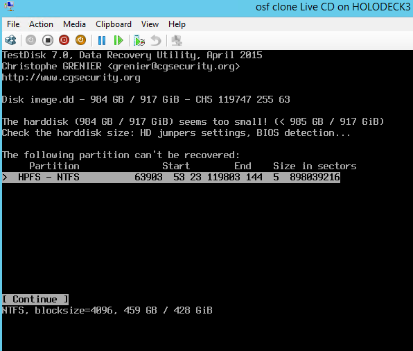

          TestDisk won't repair the partition table:

            My problem is that the partition table in the image that TestDisk created is totally screwed up:
            And TestDisk won't recover the NTFS partition, even with a deep search:
            So cloning the entire disk image back to the drive with partitions intact doesn't seem to be an option, unfortunately. The only things I can get to read the files on the NTFS partition in the disk image are TestDisk when I select "None" as the partition type, and OSFMount.
