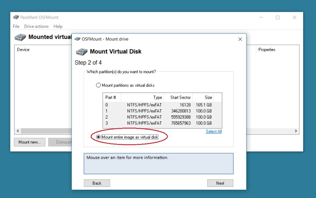

        I tested the program again and now I have the exact reproduction method.
        Out of the box, the mentioned driver "osfdisk.sys" is not installed yet.
        It gets installed after trying to mount an image of any kind, using the "Mount entire image as virtual disk" option.

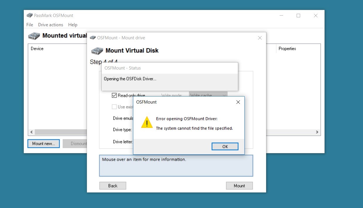

        When trying to mount using this option, I get the following error:
        This is also the part where the driver gets installed on my system.

        Anyway, this was the incorrect option for mounting my disk image.
        I did not know which option to use at first.
        So I used the "Mount partitions as virtual disks" option instead and this works fine without any problems.
        Using this option, no driver seems to be installed to the system.
        I confirmed by mounting/dismounting the image and rebooting the system multiple times
        Could you check this again and confirm that option indeed installs the "osfdisk.sys" driver?
