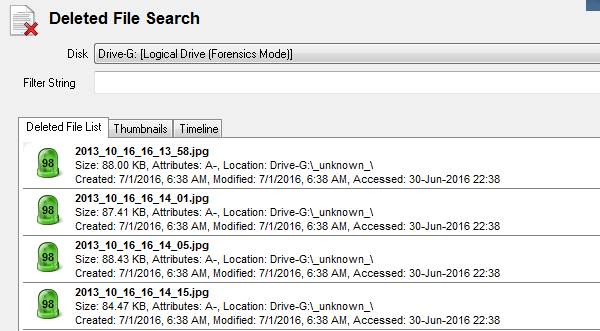

        From the result of Osforensics below, it has access time of 30 June 2016 22:38

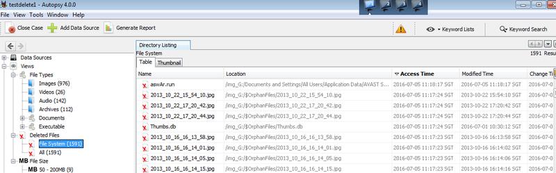

        I ran Autopsy and got the access time stamp to be 2016-07-05 11:17:23 SGT. This is correct because this is the time I access the files before performing deletion.

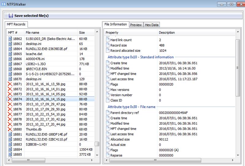

        I ran again nfswalker and get the same result as Autopsy. See result below :
        I can not explain how the access time stamps are derived in OSforensic as they do not match any of the known time stamps.

              An update on the file time issue.
              OSForensics was displaying the file times from the NTFS $FILE_NAME attribute rather than the $STANDARD_INFORMATION attribute. $STANDARD_INFORMATION contains more up-to-date file times. This will be fixed in the OSForensics V4 release.
              We are also looking into displaying both sets of file times in the internal viewer.
