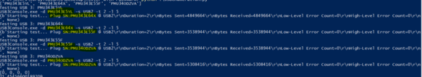

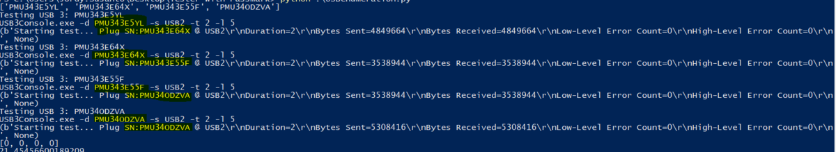

      And also during the USB2 test with the console, the SN that sent through the command does not match with what tested.
      attach is the screen shot
      • HamidK (PassMark)
        • Jul 2016
        • 47
        The error message "Failed to select speed" means you have selected a wrong speed. e.g. you have connected the plug into a USB2 port but trying to test at USB3 speed.
        For the issue of mismatch between serial numbers, please try the following build and let us know how it goes?
        https://www.passmark.com.au/ftp/USB3...e_1.0.1002.zip
        Also, In this new version we have added an option (-v) for reading the port voltage.

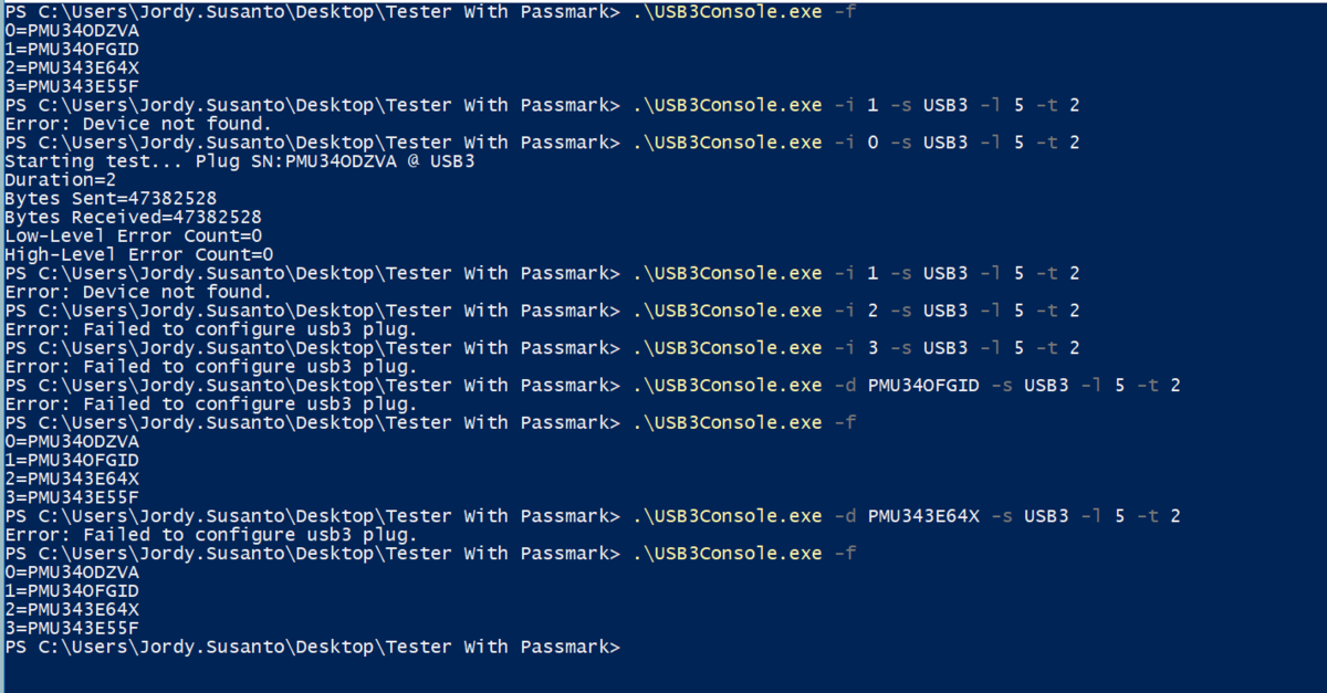

            Can you run the command line with "-f" option before and after running the test and send us the screen shot from the console output?
            • Jordy Susanto
              • Feb 2019
              Here is the screen shot:
              For the first step plug (PMU343ODZVA), I can run the test. But, all the other plug I will get the error message. Is the API or the driver using serial protocol?
              And also how long does it take for re-enumeration after changing the speed test?
              Thank you.
              • HamidK (PassMark)
                • Jul 2016
                • 47
                We made a few changes that may fix the problem. Can you try using the following build and let us know how it goes?
                https://www.passmark.com.au/ftp/USB3...e_1.0.1003.zip
