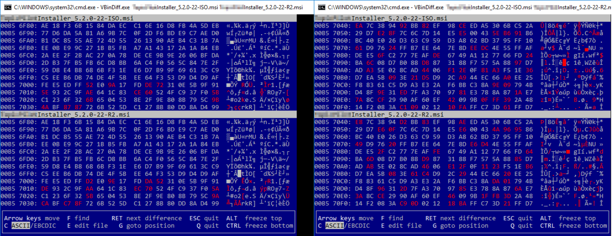

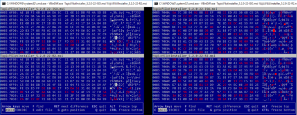

      As we suspected the resizing of the image and therefore the possibility of something cutted away we took a look a bit deeper and compared on byte level - see attachment. Click image for larger version
      The content is noisy disturbed through the whole file. Not at the begin or end.
      Interesting is, that only two of about twenty files are affected. Perhaps the data storage had some problems - even the fact we tried different ones.
        • 11135
        A lot of those differences are single bit differences, which is characteristic of hardware failure (bad RAM or bad Flash memory).
