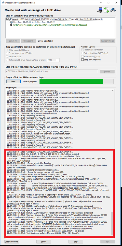

    Good morning all. I have tried three dozen times to write a .bin file to a microSD card over the last couple days. I've used three different microSD cards, all Samsung 32GB Pro cards, two different Windows 7 computers and a Windows 10 computer. The only thing that changes is the location of the failure to write, which varies by card.
    Background. The .bin file I am trying to write is a firmware update image provided by a manufacturer. The manufacturer's instructions specifically direct use of ImageUSB (see: http://docs.sotm-audio.com/doku.php?...n_sdcard_image). Although the procedure for formatting new SD cards is different in Win 7 than Win10, I ensured I started with a newly-formatted, FAT32, healthy simple volume. On the Win 10 computer I followed the manufacturer's instructions precisely. I also ensured the write file was extracted and not the compressed .gz file downloaded from the manufacturer's website. I am running ImageUSB as an administrator.
    Issue. ImageUSB indicates a full write; however, the moment the write progress says 100% I then get an error in the messages at bottom that says "Failed to write to \\.\PhysicalDrive3 at offset 2879389696 (0xaba00000)." As I mentioned above the numbers following "offset" are different when I try a different card, but always the same error.
    Any advice on what this error means and how to fix the problem is greatly appreciated!

        I downloaded the old version and received the same error. So, I went to the store and bought a new USB card reader. It is the only thing that has been consistent across all my efforts to write this image. New card reader, same error, same location.
        Edit: one other data point, and this occurs across all configurations I've used. After the write fails, Windows sees the drive as RAW instead of FAT32, and requires me to reformat the drive before I can do anything else with it.
        Any ideas? Thanks for your continued efforts.

            I purchased all the cards through Amazon (here in the US), and at different times, so I would think it unlikely that they are all fake. Tonight I also tried a Samsung 32GB EVO card, and still get the same errors. Moments ago I tried partitioning the card at 14.9GB and 32k file allocation size to see if that would help, but I still receive the same error.
            Edit: I've now run ImageUSB in debug mode, and found something interesting. ImageUSB detects 4 partitions on the SD card despite the fact I formatted the card as a simple volume with only 1 partition of the full size of the drive (post-formatted).
            Does this information help you troubleshoot?

                  I am wondering if the card reader only allow full sectors to be written.
                  Image Size: 2,880,054,499 Bytes
                  Data written before error: 2,879,389,696 bytes
                  Data remaining: 664,803 byes.
                  Error 87 (from the log) means parameter is incorrect on the Microsoft WriteFile function.
                  Possible reasons for error 87 include.
                  1) The file size is too large (e.g. > 16TB in NTFS).
                  2) The device was opened in non-buffered mode and the write length isn't a multiple of the drive's sector size
                  3) The device was opened for asynchronous I/O, but WriteFile is then called without the OVERLAPPED structure.
                  4) A write was attempted when the volume hasn't been locked with winioctl-fsctl_lock_volume
                  But none of these really apply in this case. I am suspecting a problem with the card reader's device driver. Maybe we can try padding out the last write command to be a full sector, or padding the source file out to be a multiple of a full sector (e.g. append a bunch of zeros on the end).
