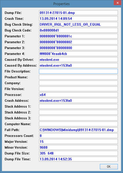

        But what I found out with the tool "BlueScreenView", is that every time the problem occurs, a driver_irql_not_less_or_equal bluescreen is thrown obviously, though the screen actually does not turn into a bluescreen. See detailed information attached.
        Any new suggestions for resolving this problem?
        Thanks again!
        Cheers
          • 11135
          So this is a pretty specific crash in the core of the operating system.
          If you Google for,
          driver_irql_not_less_or_equal ntoskrnl.exe+153fa0
          There are a bunch of results. I suggest you work through them and see if any of the solutions apply to your case.
          Our Sleeper software won't fix the problem as these driver_irql problems are almost always a results of bugs in the device driver software. There are a few people also blaming anti-virus software in this case as well (but they also use device drivers for low level access to the machine).
