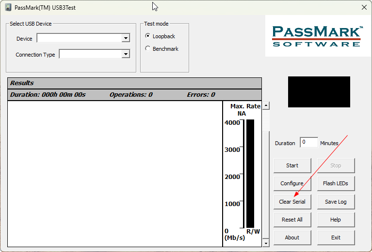

    What is the Clear Serial Button for in the UUSB3 Tester Software? Can't find anything about it. Have attached file.

    The "Clear Serial" button is only used when you open the USB3 Tester Software from the command line using the "/S" command line argument. If you do this, then a text box will be added into the software that allows you to enter in a serial number and the "Clear Serial" button clears this text box. This feature is only used by a small percentage of users and it was added to assist in simplifying the process when doing bulk testing of many devices.
    We have updated the users guide for the USB3 Test plug now so that it includes information on the different command line arguments that can be used and have made a mention of the Clear Serial button in it now.
