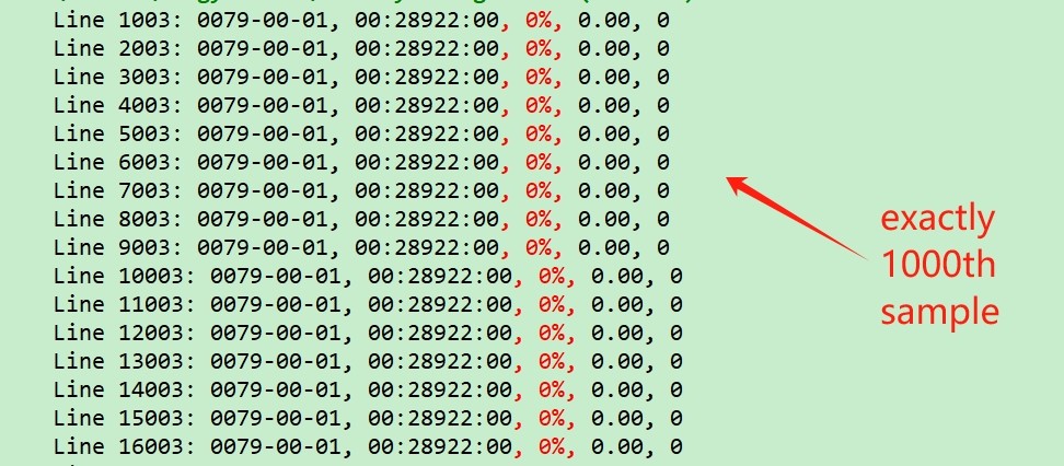

why log occurs "0079-00-01, 00:28922:00, 0%, 0.00, 0"
  • keydongle
    • Aug 2024

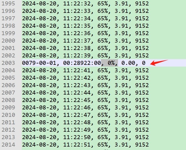

    when use batterymon to log battery information,during this period, log file occurs "0079-00-01, 00:28922:00, 0%, 0.00, 0", timestamp and others are garbled, as the picture shows, what could be the reasons ?thanks a lot!
    • 11135
    Hmmm.
    Seems to be every 1000th sample.
    Try changing the sample period to 10sec.
    We'll have a closer look
    • keydongle
      • Aug 2024
      Hmmm.
      yes, exactly every 1000th sample. thanks for advise!
      • Dimiter (PassMark)
        • Jul 2023
        • 15
        What version of BatteryMon are you using? And what OS is it running on?
        Would we be able to have entire log, including the header?
        If you're not running on the latest version, could you try your test with the latest version available here:
        https://www.passmark.com/products/batmon/price.php
