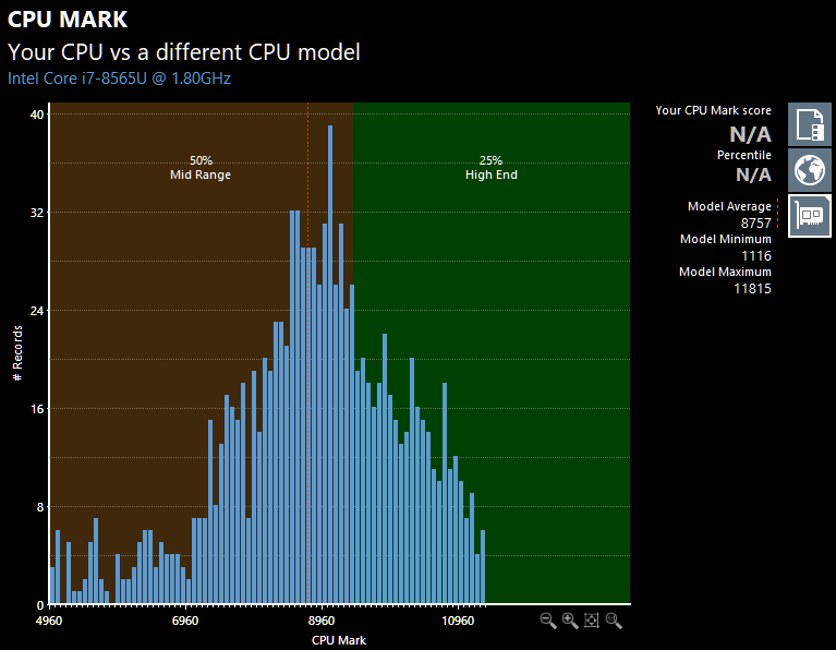

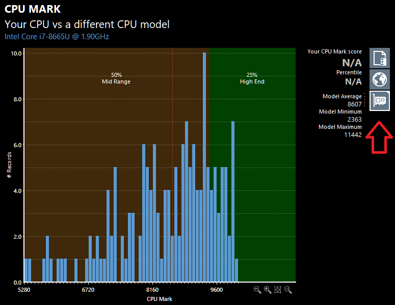

    Those two CPUs are so close that other factors move the result around a lot more than the tiny difference in clock speed. (e.g. RAM used & how aggressive the power saving settings are)
    You can see the distribution in PerformanceTest.
    All CPUs have some units at the high and low end. Especially laptops where power control, thermal issues and bad RAM configs are common.
    These CPUs aren't special in that regard.
    Click image for larger version  Name:	Distribution_i7-8665U.png Views:	0 Size:	24.2 KB ID:	46618
    Click image for larger version  Name:	Distribution_i7-8565U.png Views:	0 Size:	23.2 KB ID:	46619

        There are outliers for all CPUs. They average out in the end once there is enough samples.
        Again, the on paper performance difference for these CPUs is a small 5%. And a good or bad RAM setup, or having a thermal envelope set in BIOS can make a much larger difference than this. The i7-8565U will generate a bit more heat and getting rid of heat is a big issue in laptops.
        What it means is that you will not (on average) benefit from upgrading to a i7-8565U CPU and we think it is important information to make available. Not something we need to hide.
