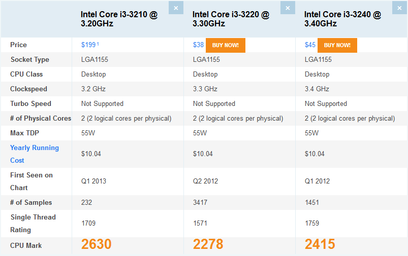

            I understand that people don't like seeing their old CPUs made to look suddenly worse.
            But this is what happens if new code is written that makes use of features that old CPUs don't have.
            It makes no difference to measure the length in inches or centimeters, if the results are repeatable, correct and can be used for comparison.
            Unfortunately, the new passmark v10 results is not connected with the actual hardware structure of the processor
            and therefore (since March 2020) is almost useless for comparison.

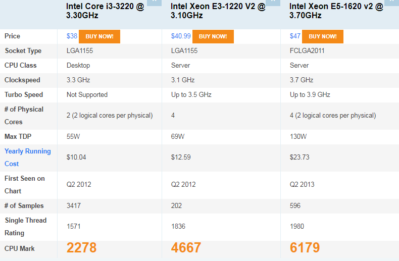

            An example
            Click image for larger version  Name:	1PM3.png Views:	0 Size:	32.4 KB ID:	46859
            i3 - 3220 (3.3 Mhz, 2 cores & 4 threads) - raiting 2278 in the new version
            E3-1220 v2 (3.1 Mhz, 4 cores & 4 threads) - raiting 4667 in the new version.
            E5-1620 v2 (3.7 Mhz, 4 cores & 8 threads) - raiting 6179 in the new version.
            Those. according to the new test (at almost the same clock frequencies and exacly same "Ivy Bridge" CPU manufacturing technology):
            1) The hyper trading mode is useless, judging by the difference between (1) and (2).
            2) An increase in the number of threads by 2 (two) times, from 4 to 8, creates a change in productivity + 11%?
            (The frequency of the processor E5-1620 v2 is 20% higher than that of the E3-1220 v2).

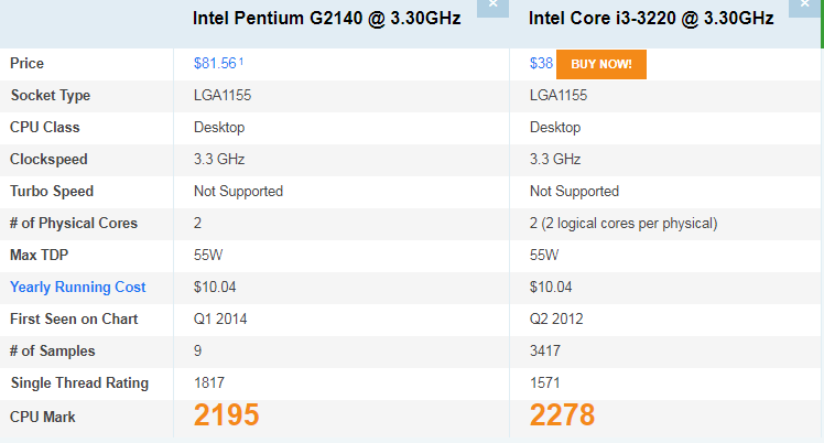

            Click image for larger version  Name:	1PM4.png Views:	0 Size:	25.5 KB ID:	46861
            The hyper trading mode is useless, judging by the 3,78% difference between G2140 and i3-3220
            (with exacly same frequency & Ivy Bridge tech.)
            New v10 test results has nothing to do with real hardware
            (and with fact CPU speed and perfomance in usual user's tasks).
            Therefore, the new results are completely devoid of physical and practical meaning in terms of comparison.

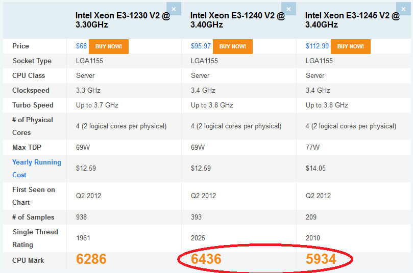

                  Unfortunally, Passmark are no longer credible...
                    Honestly this comes across as more of a rant than a sensible argument. There is only a couple of us working on this, but we have 3M+ users. So time available to respond to each user is pretty limited. So I'll just focus on the 1st post but the comments apply generally for all CPUs.
                    Super briefly.
                    1. "hyper trading mode" isn't even a thing. I guess you are talking about hyper-threading. But making up terminology (or getting it wrong) doesn't help your credibility.
                    2. You've ignored turbo speeds. The i3-3200 doesn't turbo at all.
                    3. CPUs don't run at Mhz frequencies. They run at Ghz. Typo or ignorance? Either way it doesn't help your credibility
                    4. 3.1Ghz" isn't "almost the same" as 3.7Ghz. It's a 20% difference.
                    5. The benefits of hyper threading (virtual cores) is very variable. In some situations it hurts performance. So 4 physical cores are significantly better than 2 physical + 2 virtual. See my screen shot below. It is also very hard to predict in advance when it will help and when it won't.
                    6. You've completely ignored the massive differences in cache. i3-3220 has just 3MB. While E5-1620V2 has 10MB
                    7. You've ignored differences in number of memory channels (2 vs 4). Probably a good chuck on those 3200 machines were on single channel.
                    8. You've ignored differences in the max memory speed (DDR3 1600 vs DDR 1866)
                    9. You've ignored instruction set differences. For example support of accelerated encryption (AES) in the Xeons.
                    10. As already stated scores are going to move around a bit until new averages are found.

                        Thank you, David!
                        English is not my native language, so thank you for the corrections
                        (although I love to think and write in English)
                        Of course, the frequency in GHz... and "hyper threading" is right too ...
                        According to Passmark v10 benchmarks, the Xeon e5-1620 v2 is 30% faster than the Xeon E3-1220 v2 (6179/4667)
                        Given that the clock frequency of the Xeon e5-1620 v2 is 20% higher (3700 MHz or 3.7 GHz)
                        compared to the Xeon E3-1220 v2 (3100 MHz or 3.1 GHz), the performance to frequency ratio is higher by 11 %
                        1) e5-1620 v2 has 8 threads compared to 4 for E3-1220 v2;
                        2) e5-1620 v2 has 1866 Mhz RAM speed compared to 1600MHz E3-1220 v2;
                        3) e5-1620 v2 has 4 channels of access to RAM compared to 2 channels of E3-1220 v2.
                        According to Passmark v9 results (9504/6760) adjusted for the difference in frequencies, the ratio of performance to frequency E5-1620 v2 is higher by 17.6%
                        It seems that the new Passmark v10 “does not like” hyper threading
                        and reduces its influence on the final result by at least 1.6 times compared to Passmark v9 in this case.
                        For a pair of Intel i3 3220/3230/3240 to Pentium 2120/2130/2140 and the average ratio in Passmark v9 = +28% (for hyper threading reason)
                        In the new Passmark v10, this ratio = +14%
                        The effect of hyper treading on the final result is reduced by at least 2 (two) times compared to Passmark v9 in this case.
                        Therefore, at first glance, the new Passmark v10 results wither and testify: gyper threading is almost useless.
