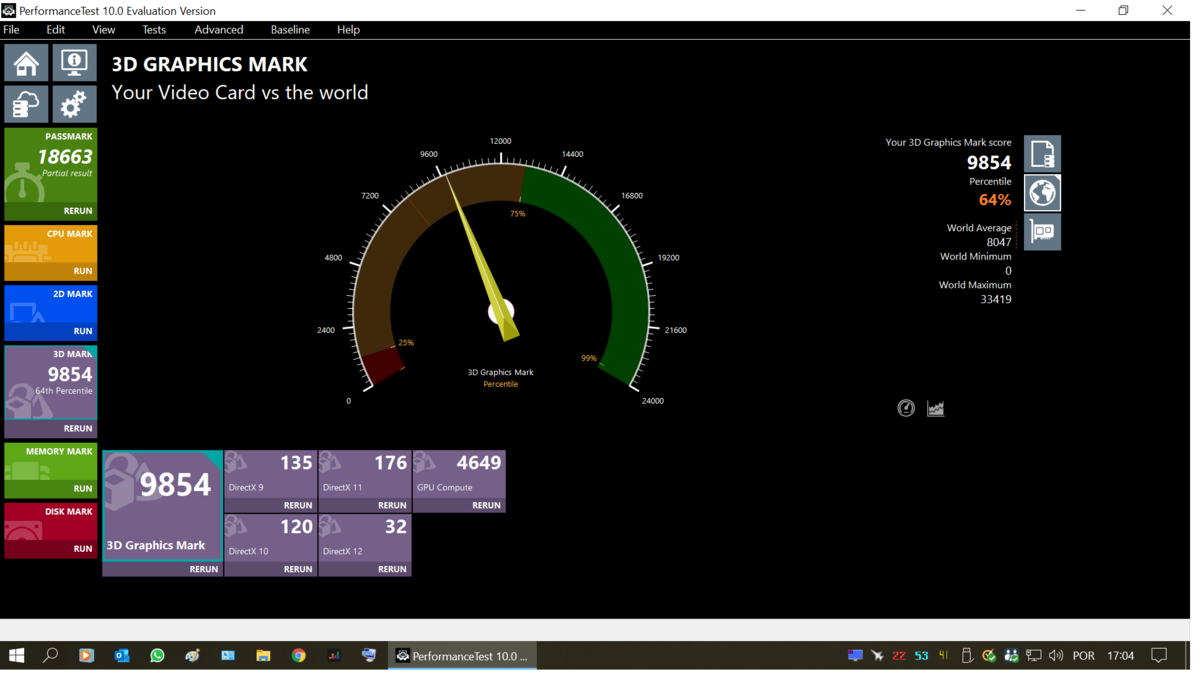

    Results:
    first result (1 click only at 3d graphics mark) with "application controlled settings", norton family and antivirus on, rivatuner disabled but installed etcx., cpu fx-8320e 4120mhz with nb_cpu and ht_link 2060mhz, physx GPU.
    MSi afterburner (GPU overclock etc.)
    ​Click image for larger version  Name:	1ptest 9854 controlado 100%aplicativo + performance.png Views:	0 Size:	183.2 KB ID:	49075​
