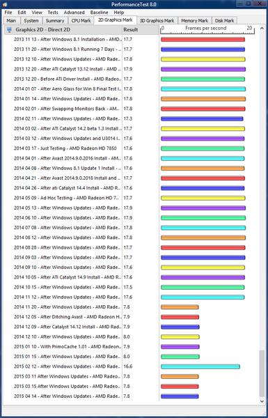

          I have been wondering about this EXACT SAME problem since November of last year.
          I believe a Windows 8.1 Update destroyed Direct2D performance.
          As I have an ATI card, it's clear it's not related to specific display drivers or even to the brand of graphics card.
          I do Passmark benchmarking regularly - I have for years - in order to spot problems or trends, so I can pinpoint exactly when this slowdown happened. Note the screen grab below.
          The only place it gets a little odd for me: After a Windows Update in Mid February, performance of the Direct 2D benchmark seem to mostly return, but then it went back to dismal levels after the very next update.
          -Noel

                We had another customer complain of similar behaviour in the Direct2D last week and did a bit more investigation.
                What we found that the Direct2D benchmark results jumped between a slow and fast result (like in the chart posted above). Our test was on a Intel GPU, so it isn't something that is in the video card device drivers, as the post above was a AMD GPU.
                What we saw was that that you didn't need a patch update to observe the fast / slow behaviour. You could run the test 100 times and then maybe 5 times in 100, you would get a fast result. The other 95 runs would give a slow result. We were unable to find a pattern or trigger condition that would to force a fast result. While there is probably some deeper cause, it superficially at least seems random.
                We also tested on Win10 and Win7 (but with different hardware) but didn't see this behaviour. The Direct2D results were very consistent on Win10 and Win7.
                Our theory at the moment is that there was a Win8 operating system patch that broke Direct2D some time back and Microsoft never noticed.

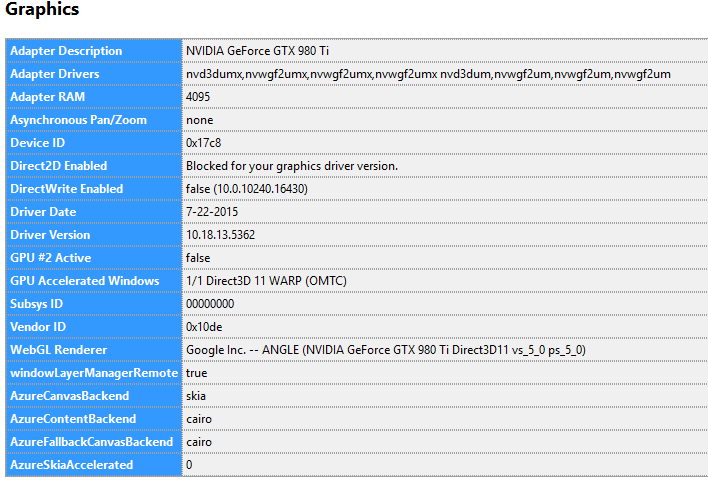

                        Hmm, According to Firefox Direct2D is Blocked for the graphics driver version.
                        went to about:support in firefox down under graphics.
                        It appears the D2D is disabled on the latest driver versions.
                          I don't think so. I think you are interpreting the information from Firefox incorrectly. I think this means that Firefox decided that Direct2D didn't work so well on your machine (or they haven't tested it yet) and so they didn't use it from Firefox. I don't think this say anything about the availability of Direct2D in the O/S.
