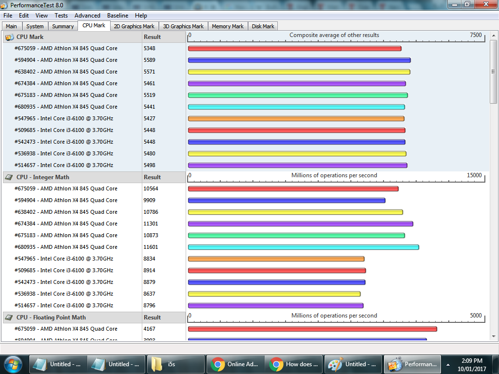

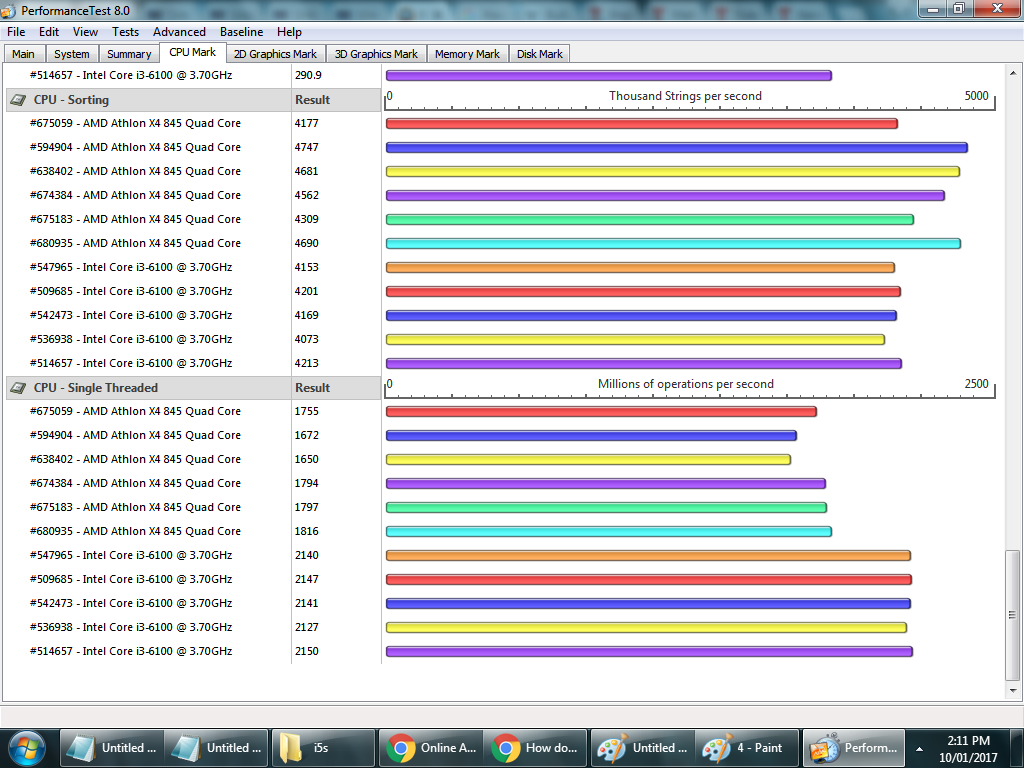

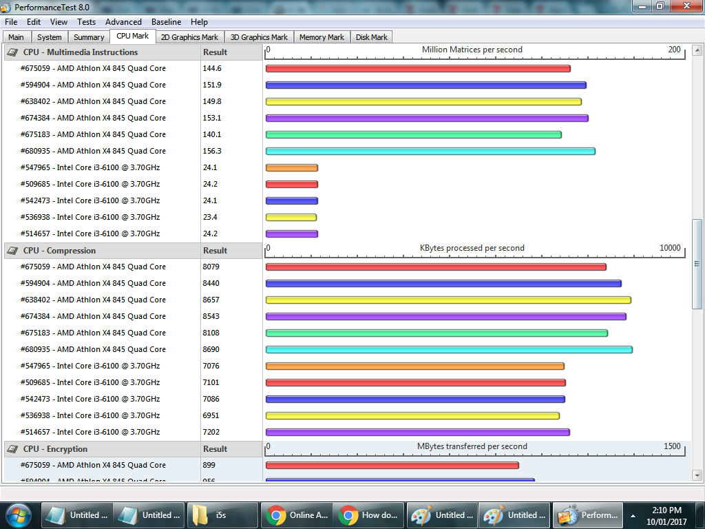

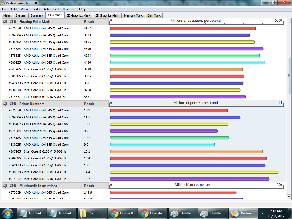

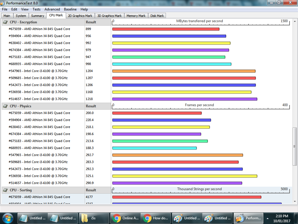

            So , i ve included some attachments.
            Games are supposed to depend on floating point performance and others as well and Athlon is considerably quicker in those cases.
            With that said, as per your suggestion, i can check benchmark of games. But the results were inconsistent or unavailable. The gameplay can be at various resolution,quality settings and gpu. Also, there are times Athlon be as quick(Asssin creed Syndicate,witcher 3,etc) as i3 6100 or slower/faster. Add in the factor that videos of Athlon were rare as it's a low budget cpu .There were also many deceiving fan-made videos, let alone videos with inaccurate(extremely slow gameplays,comparatively) results. For example some even recommends pentium against the quad core athlons.
            Afterall, most people without problem don't bother to make videos and some may have other issues with their setup(not limited to this cpu,brand,etc)
            And those not the only games i am play.
            But im getting somewhere now. Thank you for the tips again.

              Cpu scores

                cpu score 2
                  I just noticed you are running the old PerformanceTest V8 release.
                  You should use V9 instead.
                  There were significant changes. For example, V8 didn't use the Bullet Physics engine, but used the Tokamak engine instead.
