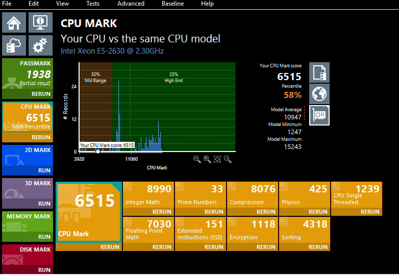

    So, I finally went and bought upgrades for my dual capable Dell T5600 and was doing some benchmarking to make sure I got what I expected and found the single CPU was running about 4900 for CPU Mark. I had HT off, as my apps don't use it, so turned it on and got about 6500. But the average is 10947, so I want to make sure I deal with any issues before adding more variables. Separate RAM (40GB - 16/16/4/4) and hard disk (striped 7200 drives) benchmarks look great. I'm running a Quadro 5000 and Dell H310 RAID.
    I've checked BIOS and msconfig settings and can't seem to find anything to explain the discrepancy. Even the charts show the 2630 should be around 8900 (not sure why the chart numbers are lower than the app results).
    Any ideas?

      I let the app adjust the processes (but Task Manager already showed 12 logical processors) and got up to 8100, so about 10% off of the chart, but more than 25% below the app.

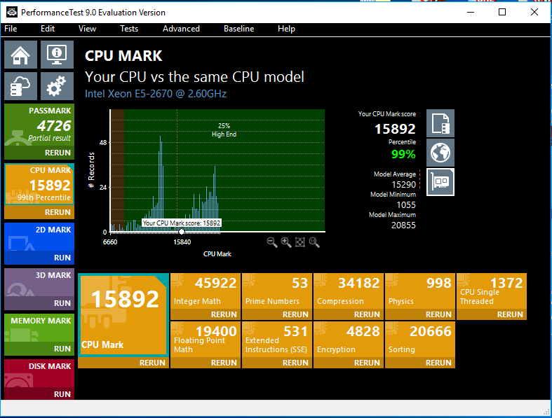

            Okay, upgraded to E5-2670 and get about 11250, right about 25% slower than the average.
            • #7
              For some reason, the dual scores are much closer to average. Actually, a little above.
              *Well, for the app values. This is low 13% from the charts.

                I've checked how the average is being calculated in PT and the results displayed for the selected/same model in PerformanceTest is an average of all results in the database for that model, including systems with more than one CPU. So on Xeon systems with only one CPU the result will look a little slower and on multi CPU system will look closer to average.
                • #9
                  Oh. What's the thinking behind that? It seems if there is a separate multi CPU chart the data would be separated.
                  • #10
                    Having more than one available result per CPU model complicates the chart generation and lookup considerably I believe and would then need a separate result for each possible combination. For the time being we are leaving it as it is but will make sure it's noted in the FAQ and help file.
