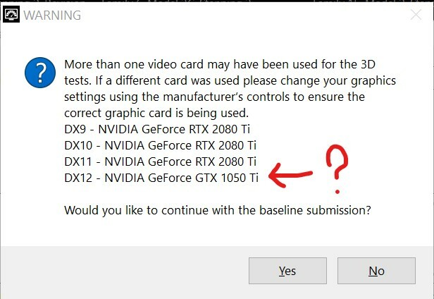

    Hey PassMark, love your app but I am having a weird thing happen. As you can see I have two GPU's in my unit and the software uses the correct GPU (2080 ti) for every test except the DX12 test? I can find nowhere to force the GPU used for the test like you have for the hard drives? Maybe that too needs to be selectable? Or is this just a bug?

    Thanks for reading!
    -Trent / axiomatic13
    Generally PerformanceTest has very little control over what GPU is used, that is mostly controlled via the Nvidia control panel (on system with integrated/high performance cards) or what outputs are connected at the time.
    Could you please launch PerformanceTest in debug mode, run the 3D tests and then and send us a copy of the log files that are generated.

            Thanks for that, could you please try this updated build of the DX12 test and if it still chooses the wrong card please send us another log.
            You will need to unzip the updated test into the directory where you have installed PerformanceTest (eg C:\Program Files\PerformanceTest).

              Hey Tim, that fixed it for sure! Will this fix make it to the release product eventually? Super pleased. Thank you for resolving this.
                Yes, the fix is available in the just released 9.0 Build 1031.
