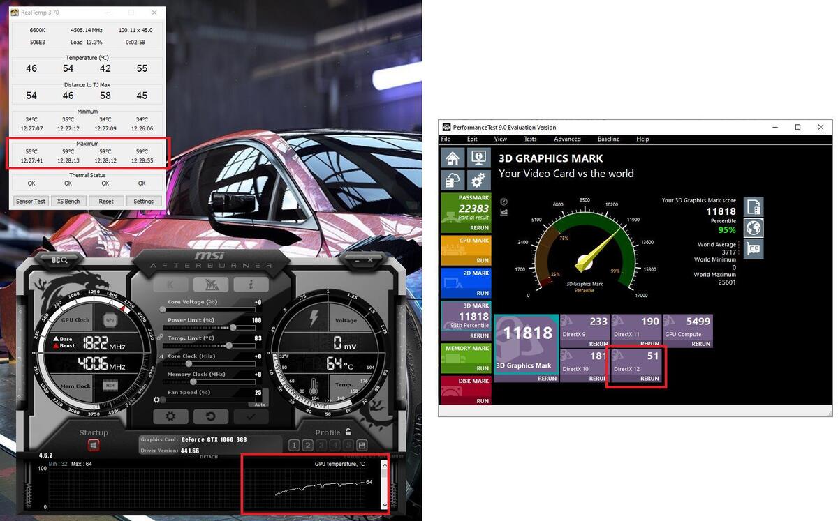

      Thanks for your response. The temperature of the GPU does not exceed 47C in Afterburner while running the 3DMark tests. And the CPU temps don't exceed 53C in RealTemp. Ive added a screenshot of these monitoring softwares which I ran open on a second screen while I ran Passmark 3DMark on the first screen (yes I'm in the last days of evaluation, but intend to purchase after that). Click image for larger version  Name:	vThsBw1.png Views:	0 Size:	421.8 KB ID:	46138
      The monitor which I use is an ASUS VG24QE - it has no support for G-sync or Freesync. I have ran the tests while on 144hz, and 60hz, but no difference. I have ran 3DMark with only my first screen connected, no difference. Then I ran it on my second screen with only the second screen connected (HP w2408h - 60hz panel), also no difference.

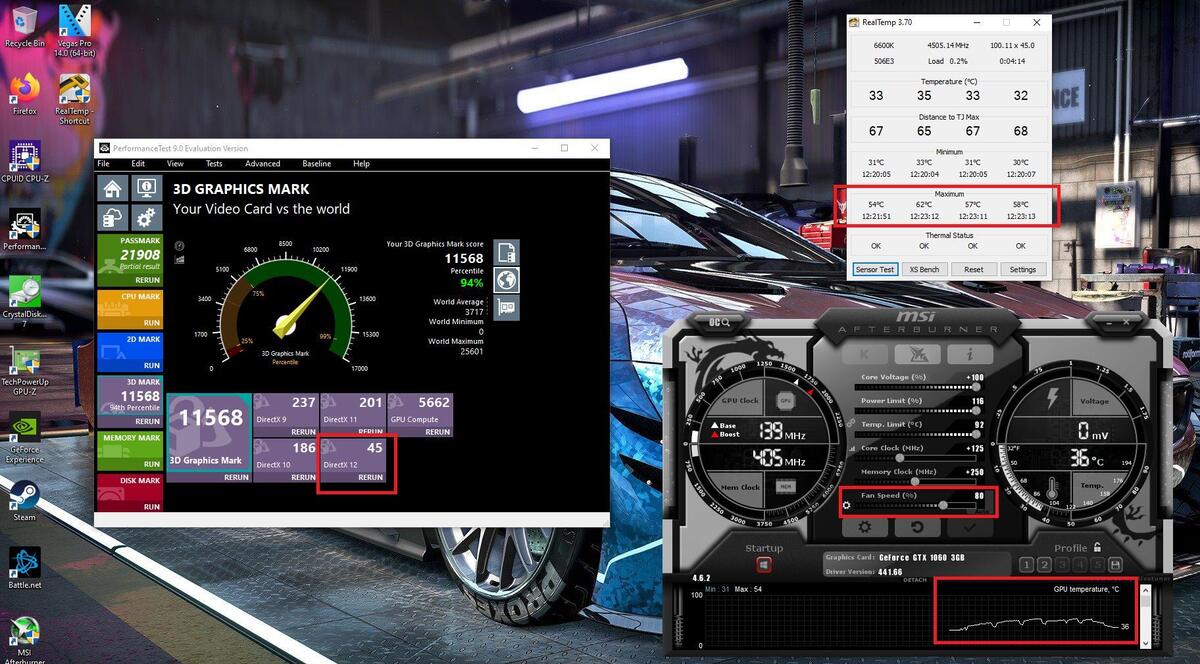

        So I have placed the card in my system #2 (i5-6600k 4.5Ghz, 2400Mhz RAM, 700w PSU). Then I ran PassMark's 3DMark at stock GPU speeds, and then overclocked. I had to turn the overclock back a bit because otherwise it wouldn't run on this system. Now every score goes up with the OC, also the dx12 score. I left fan speed on AUTO when I ran stock, and the temps while benchmarking stock went up as high as 64C, while I put fan speed on 80% while benchmarking with the OC and the temps now didn't exceed 50C.
        So there seems to be something off in my other system (system #1). I will try the other PSU.
        Stock in the i5-6600K system:
        Click image for larger version  Name:	sHqflMz.jpg Views:	0 Size:	128.2 KB ID:	46140
        OC in the i5-6600K system:
        Click image for larger version  Name:	kXUfIpK.jpg Views:	0 Size:	153.3 KB ID:	46142

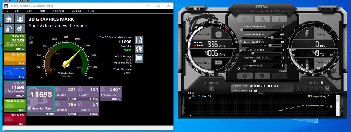

          Update: so I placed the 700w PSU in the i5-4690k 4.5Ghz system (system #1).
          Again, same results. A dX12 score of ~30. At stock I get a score of ~ 50. At least It's not a PSU problem - that's determined now.
          Palit GTX 1060 3GB in the 4690K system, with 700w PSU, OC:
          Click image for larger version  Name:	rL3lJfw.png Views:	0 Size:	379.7 KB ID:	46144

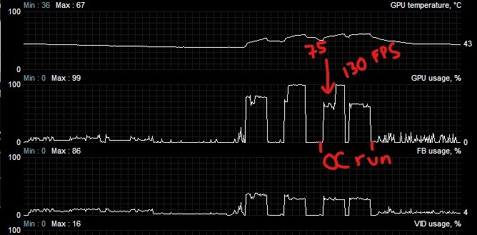

                        In the DX12 test it will almost never perform well when overclocked and more than half the time it will perform properly while at stock clock speed but not reliably. It doesn't happen in Furmark or when playing games so that leads me to think it's a software issue with the performance test.
                        I can check the monitor in Afterburner and see when it goes in and out of "fast" mode, but it's completely random and I can't seem to pin down anything that is causing it. You can see in the results below it wasn't working correctly at the beginning of the test (75 FPS) and then shot up to 130 and the monitor shows the GPU usage reflects the improved performance. When I ran the test a second time it stayed slow. The runs right before that were at stock clock and it ran at 120-125 FPS for most of the test.

                          Seems unlikely, as the range for a 1060 video card in DX12 is more around 25 to 60 FPS and not the 75 to 130FPS you are reporting.
                          Comparing the range of values for the GTX 1060 and the 2080TI, it is clear that there is a bigger range of values for the 1060 and it has a several peaks. While the 2080 is closer to a bell curve.
                          Click image for larger version  Name:	1060.png Views:	0 Size:	15.8 KB ID:	47429
                          2080ti results
                          Having multiple peaks is fairly common however. It generally means there are several common mis-configurations, or several common overclock settings.
                          A common mis-configuration for example would be seeing frame rate limiting at the monitors refresh rate (often 60Hz / ~59 FPS), or differences in behavior with different device driver versions.
                          To have such a clear step in the performance 75 <==> 130FPS and to only see it more often with an overclock almost surely means there is some throttling somewhere.
                          The 1060 and 1080 cards seem to have a thing called NVIDIA Boost 3.0, which can cause GPU clock speed changes even at relatively low temperatures. There is also a voltage factor.
                          See,
                          https://www.techpowerup.com/review/n...x-1080/29.html
                          So maybe that is the explanation?
                          The difference with other benchmarks might be the short duration of the DX12 benchmark. It is short enough that no stable temperature is found. If you adjust the test preferences to run the test for longer, the results might be more consistent. Just speculation.
