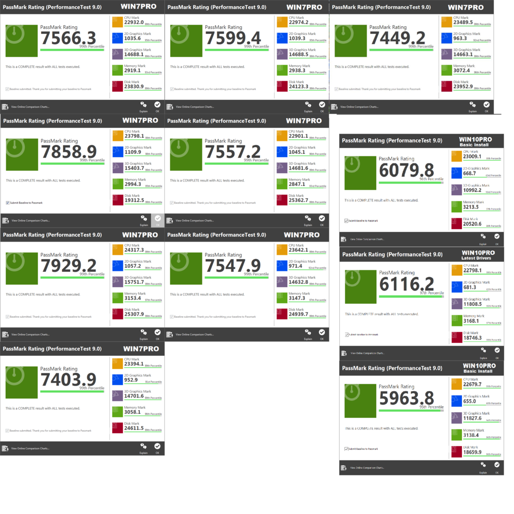

    My Passmark score was 7500+ in Windows 7. My Passmark scroe is 6000 in Windows 10. Anyone else see this sort of huge drop in performance? And yes, I have installed all the latest drivers, and that's made no improvement.
    The places it is radically different is SSD (25k down to 18k) and GPU (14k down to 11k). Oddly, CPU benchmarks are about the same (about 23k).
    Here are some of my tests.
Name:	Passmark Win7 & Win10.png

    Drop in 2D and Disk result are likely the result of security patches. Spectre & Meltdown class of security issues causes all API calls to be slower. Which effects disk and 2D the most. Then there was the more recent Win10 KB4512578 patch, which caused another (up to) 30% drop. Maybe there are also some driver differences for your hardware.
    3D result might be due to different tests being run. In Win10 you have access to DirectX12 at 4K resolution. Which isn't available on Win7.

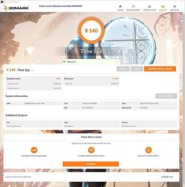

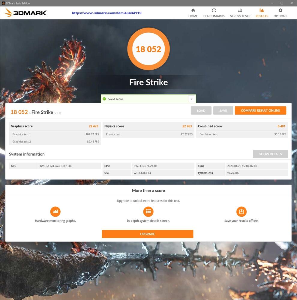

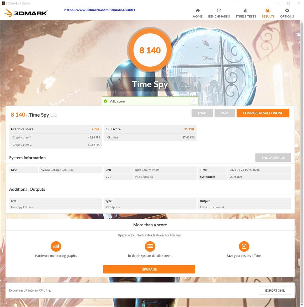

                      A couple of 'other' benchmarks - that unlike Passmark - show my system is performing reasonably well compared to similar systems. Yet Passmark says my system is the lowest ever tested... go figure.
                      Firestrike is DX11, TimeSpy is DX12.
                      Firestrike: Better than 88% of all results

                      Time Spy: Better than 71% of all results

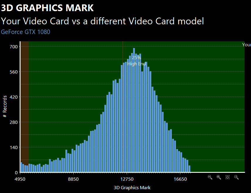

                        Here is the actual distribution for the GTX 1080 for the PassMark 3Dmark.
                        Click image for larger version  Name:	1080-distribution.png Views:	0 Size:	19.2 KB ID:	46414
                        Your result of 11,800 is within a couple of percentage points of the average (12,455 at the moment).
                        The worst ever tested is in fact a result of zero (typical of having no device driver installed). But we filter that for the distribution graph. So the lowest meaningful result is around 5000.
