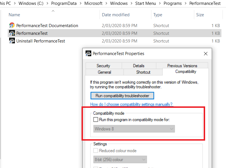

    Have the compatibility settings been turned on for PerformanceTest (see attached picture), in this case it would appear to PerformanceTest that it is running in a different version of windows.
    • #3
      OK thanks, I removed that compatibility setting and things are back to normal and all working OK!
