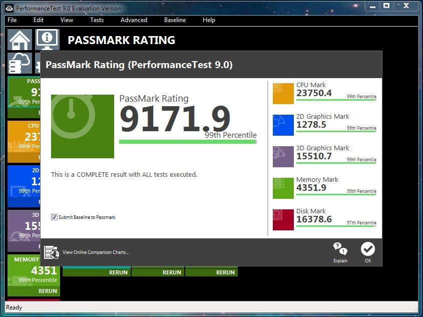

    • Arctucas
      • Sep 2009
      • 9
      Yes, W7.
      Is that what is causing the low score?
      In PT9 my rig was like 99th percentile.
      • Arctucas
        • Sep 2009
        • 9
Name:	PT9a 4-5-20.JPG
ID:	47148Click image for larger version  Name:	PT9 4-5-20.JPG Views:	0 Size:	71.9 KB ID:	47147
        Originally posted by Arctucas
        Yes, W7.
          Some test scores and the 2D mark value in older versions of Windows (eg Windows 7) will be far lower in PerformanceTest V10 as it isn't possible to scale meaningfully when multiple tests can't be run.
          Newer versions of Windows have added more available drawing APIs such as PDF and SVG rendering functions. The PDF and SVG test will not be able to run in Windows 7 at all due to missing Windows API functions. The DX11 parts of the Image Filters and Image Rendering test may be able to run in Windows 7 if DX11 is installed and a DX11 compatible video card is being used.
