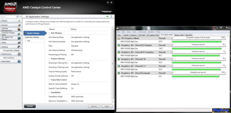

    Problem is in your 3d application settings in AMD Control Center (probably its the same with Nvidia application)
    If you lower your application settings to low quality like turn off Morphological filtering and Surface optimization and set your Antialiasing to Multisampling etc. your 2D and 3D scores will be higher.
    I think this should be fixed, so that none of the settings in AMD CCC does not affect the scores in Performance test

      well in my case it depends if i use morphological filtering or surface optimization or performance instead of high quality textures even if i use "Use application settings" option.
      Here is prove
      PT should not depend on AMD CCC settings

        And Anti Aliasing settings have great impact on PT 3D scores:
        Direct x 9 Simple test:
        Changing Anti Aliasing filter from Edge detect to Standard causes 4-6 pts increase, and changing Anti Aliasing method from Supersampling to Multisampling causes 30 pts increase and vise versa.
        Direct x 9 Complex test:
        Morphological filtering off increases score by 3 - 5 pts , Supersampling on decrease score by 13.6 pts. Lowering other settings and turning off Surface optimization increase score by 3 more pts.

          here changing from high quality to low quality in Catalyst Control center raises score by 225, and thats not little
          from
          to

            Well higher settings have an impact on 3d scores even if we use "Use application settings"
            That should be fixed!

                Today I wanted to test my R9 270.
                first test was with "use application settings" setting on high
                dx 9 complex scored 66 FPS
                then I tested with "use application settings" and lower the texture filtering and AA modes, turned off morphological filtering and surface optimizatio, my score went from 66 to 109.4. Allmost double.
                it would be good that AMDs CCC and Nvidia control panel have no impact on Performance test scores. One way this could be achived is with high setting usage in program itself, so if AF is x16 in Performance Test and x16 or x2 in CCC, the final score will be calculated with x16 AF, because its set so by Performance test. Same with textures, use highest setting possible, and then even if a user sets textures to low in AMD CCC or Nvidia CP, the highest setting will be used because its been set so by Performance test, and then final scores will not fluctuate so much.
