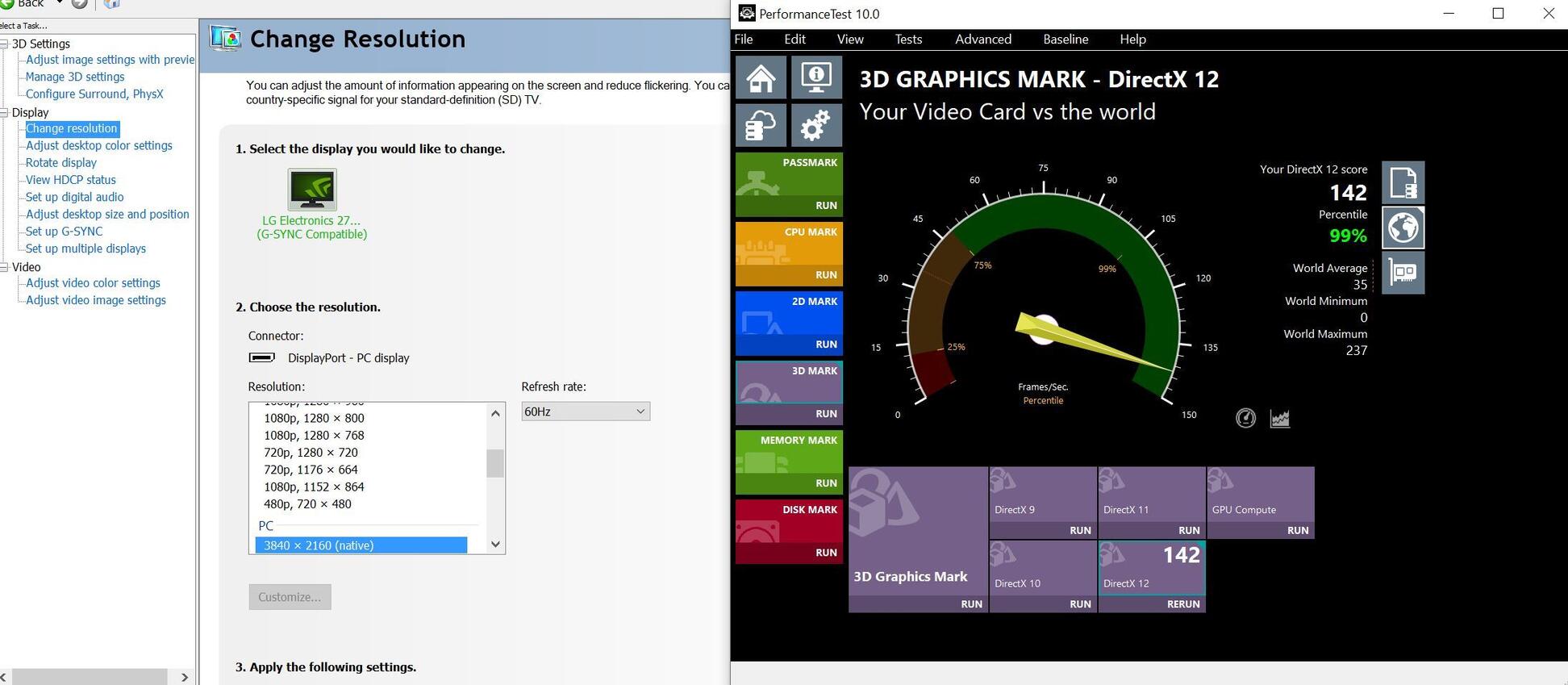

                  I use an LG 27GN950B 4k monitor with 10 bit (8-bit + frc) colour and Freesync + G-Sync.

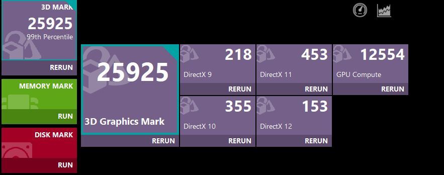

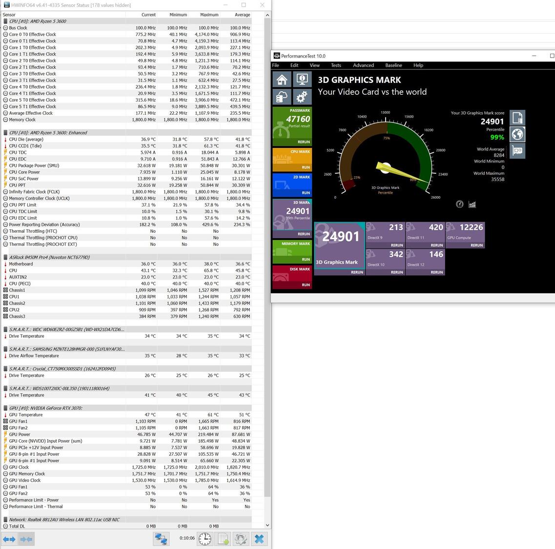

                  I get a 3D Graphics score (in Performance Test 10.0) of about 26285, and a DX12 score of 162 using a Gigabyte Eagle RTX3070
                  When I turn off all my tuning enhancements (CPU/IF/Mem back to 3600, memory completely at XFR2 defaults), I get 25925. That's only -1.4% down (hardly worth the effort, for framerates!)

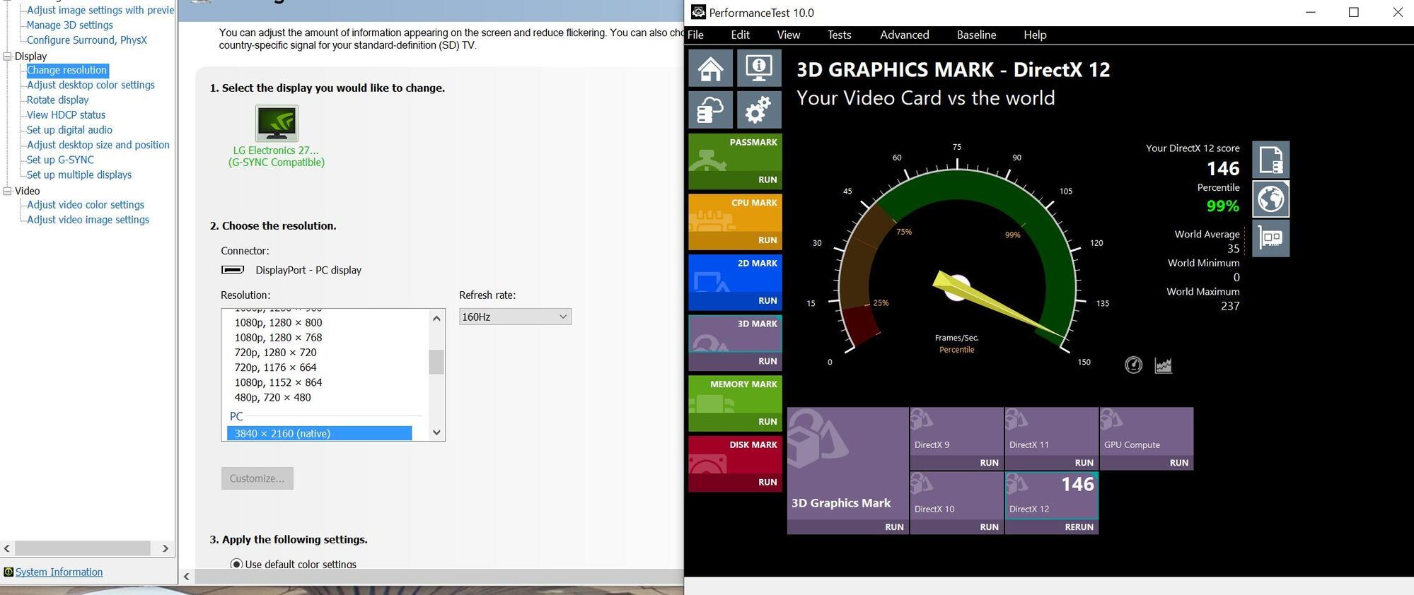

                  When I turn off all performance enhancements in NVidia's Control Panel (eg going from 'Performance' to 'Quality' throughout), the result is 24986, or about -4%. The DX12 number is 146.
                  As you can see from the AIDA64 'maximum' columns, the system is not at all stretched.
                  The GPU operates at a maximum of 219w (against another run: giving 24901, DX12 146.
                  This is Radeon RX6900XT level performance, according to Passmark.
                  I'm using a lower tier RTX3070 (220w-240w) at the lowest end (220w). I don't think there are any 3070s lower than that.
                  I can only think of one bit of technology that might be impacting this - compression over DisplayPort, providing higher framerates, or maybe G-Sync (which is a bit of a mystery to me...).

                  Click image for larger version  Name:	image_3329.jpg Views:	3 Size:	32.1 KB ID:	49607

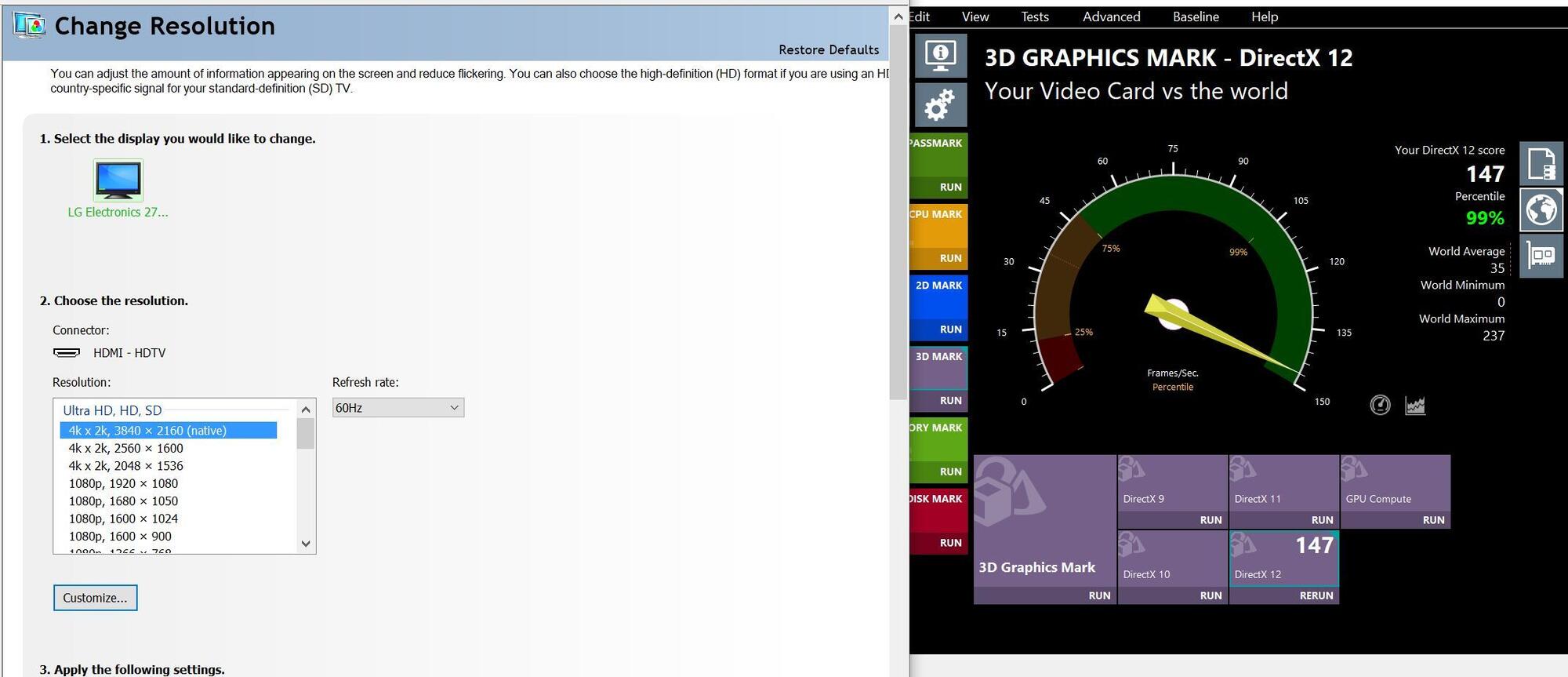

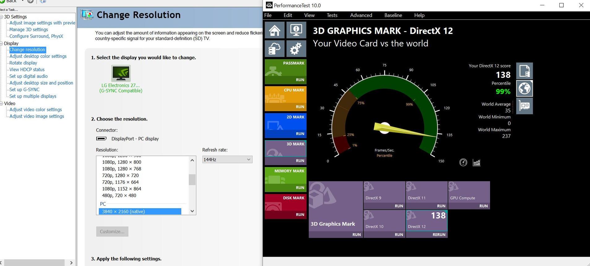

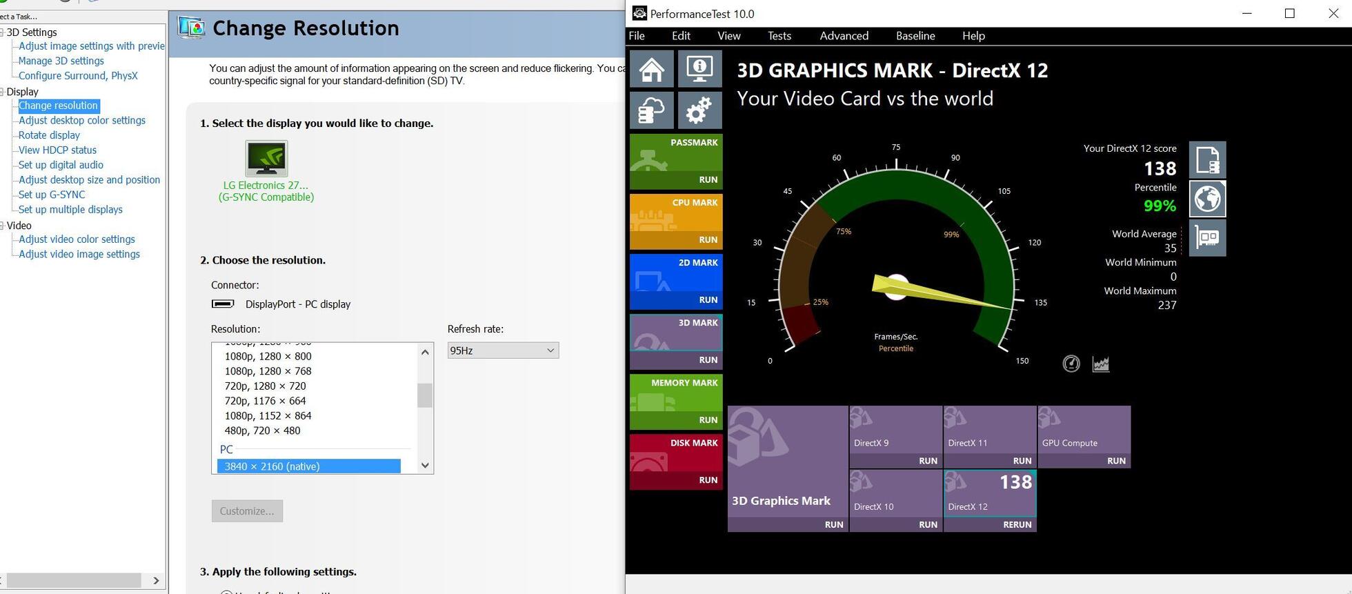

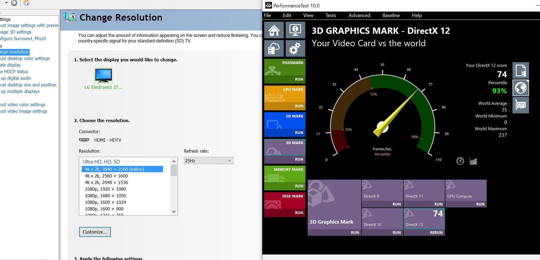

                    Further to my tests yesterday, here are some DX12 results from changing refresh rates on the 4K monitor, on its DisplayPort connection: the files all start with DX12 (followed by the refresh rate).
                    After that, I switched to HDMI at 60 Hz. This compared exactly to DisplayPort.
                    Then I went for 25Hz over HDMI: this lowered the DX12 framerate to 74.
                    Conclusion: the DX12 test seems to be 'refresh-rate invariant' (good) until it drops to 25Hz (or similar). I ran the 25Hz test twice, just to check - it was identical at 74.
                    I can't get scores below 74 in DX12 on a lower-tier RTX3070 on its lowest power setting, for any refresh rate.
                    A score of 60, on a RTX3070 is not normal in 4K.

                      Here are the 3 next refresh rate values: 60 Hz in DisplayPort, 60 Hz in HDMI, 25 Hz in HDMI.
