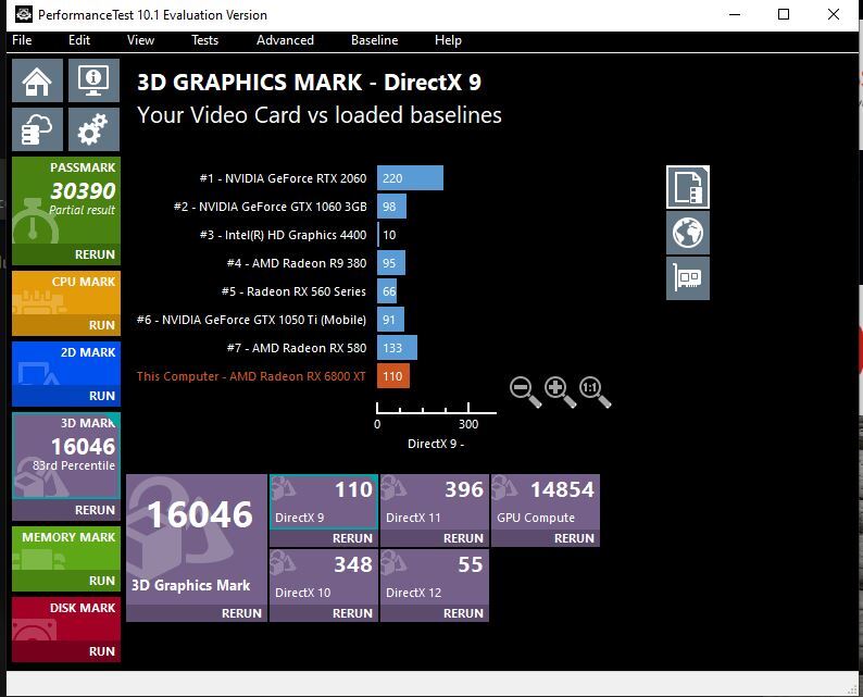

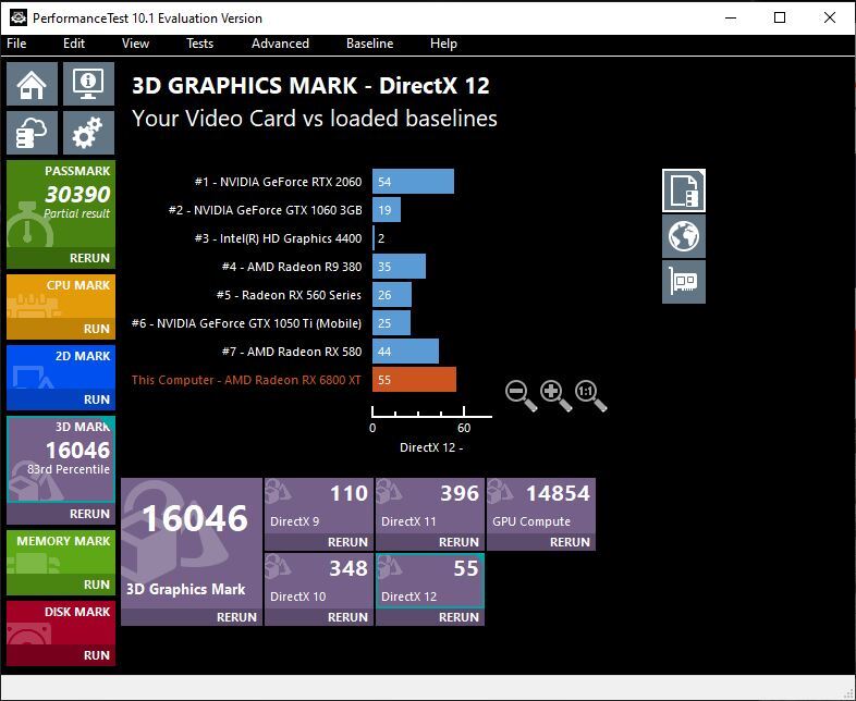

      Hello thank you for answer.
      I Install new driver from amd but nothing changed. Yes I unerstand the percentile... But I'm not sure about those results. Seems like only Dx9 and Dx12 are bad. (Photos in attachment)I also tried all older drivers with same results. PC is prefectly clean. But I did update of BIOS to F12 form gigabyte. Can Bios change results ? Anyway all programs and apps what I have In PC are legal with original Licnece, so I'm not sure what soft can do that. ? Any advice what kind of software can make my computer worse ? Temps are nice... max 74C for Vram and GPU has more less.
      For Dx9 I have wore results like AMD 580 had.. Thats so bad.

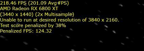

      And one more Question. What does mean this penalized score in third picture ?
        We attempt to standardize the result to 4K resolution for the DX12 test.
        Obviously if you run the test at 1080p resolution there are only 1/4 of the pixels on the display and frame rates will be much higher.
        So we scale the result down if your monitor resolution is lower than 4K.
        As for the low DX9 result, we don't know the cause of the change. But BIOS updates can definitely impact performance. There is a fairly comprehensive list of things that can cause slow performance here
        https://www.passmark.com/support/per...erformance.php

          Thanks, I will try downgrade bios, to previous version and I will let you know. Thank you.
